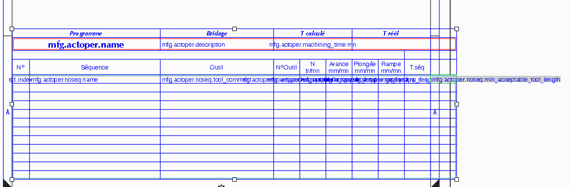

While looking at SPR resolved between Creo 3 M040 et M050, I noticed a document referring to minimal acceptable tool length. (https://support.ptc.com/appserver/cs/view/solution.jsp?source=SPR%20Viewer&n=CS206102). I tried to add this parameter to one of my tables but it doesn't show anything. Any idea how to use this ? Thanks

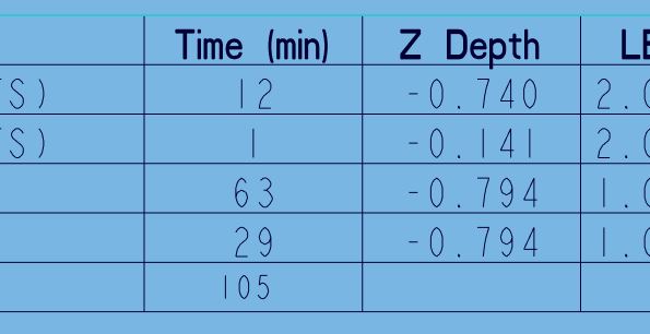

    This is the manufacturing sheet that goes to my  machine operators. The repeat region parameter is  &mfg.actoper.ncseq.Z_MIN  it shows the tool depth of cut. Very helpful to the operators.
    August 19, 2015
    I also added &mfg.actoper.ncseq.z_min for the lowest z value a tool will go.
