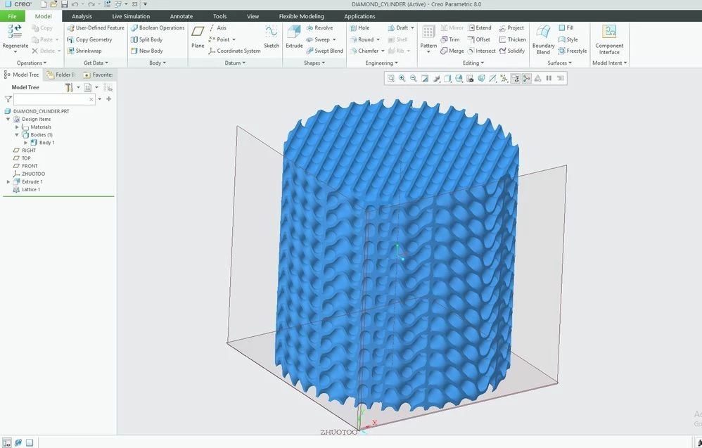

Hello, everybody,
Does anyone meet the problem when saving the part file to step, the lattice design is missing?

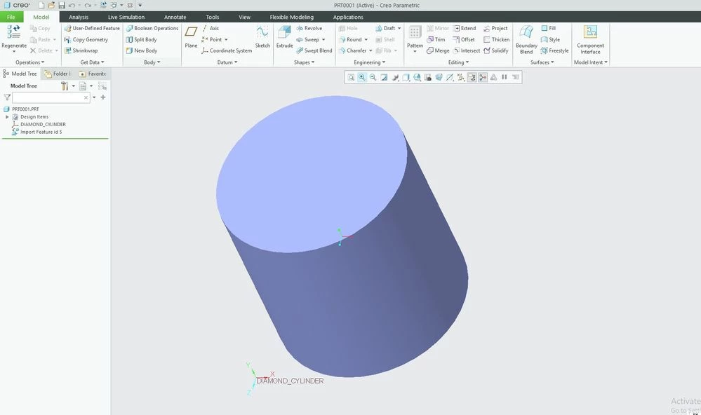

For example, in the first picture, I created a lattice structure, I then saved it as step file.
But when I open the step file, it appeared as the second picture.

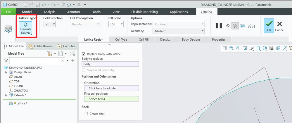

@FZ_6577930 wrote:
Hello Martin,
Yes, Creo 8.0.
The lattice is diamond.
I have uploaded the model.
thanks,
Feng
Formula driven lattice cannot be exported to STEP.
Please read https://www.ptc.com/en/support/article/cs303867 document.
