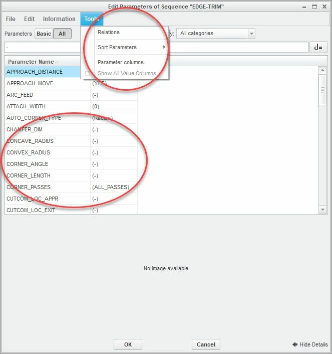

missing parameters and visibility option in the tools drop down within edit parameters window
I am using Creo Parametric - Release 3.0 (connected) 3.0 M100
Edit Parameters Tools menu is missing options and the parameter list is abridged. There are tons of missing parameters in this particular manufacturing model. CL_DIST is a big one that my Post Processor uses and it has gone missing in the parameter list. Starting a new manufacturing file remedies the situation but I need to know how to fix the one that is already complete as there is a lot of work already done and starting over every time this happens is not a solution. I need to know how to correct this issue if it ever happens again. I did attempt to export the parameter list from a good model and open in the broken one but I receive a long list of errors stating not valid.

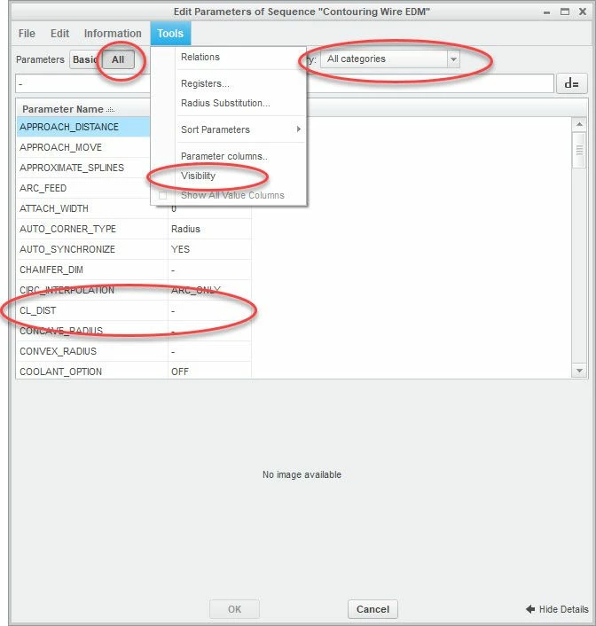

Thank you for your response Ken.  The parameters I am speaking of are not the standard parameters in the regular tools menu.  This is within the manufacturing module.  They are entirely different and the parameters that are missing are within the cutting operation.  As I mentioned, I attempted to export/import from a different model that isn't broken but that is when Creo complains and throws the errors.  There are menu options completely missing from within the tools dropdown as well.  It is a very odd situation.This is from a good modelThis is from a good modelThis is from the broken model. Visibility missing from tools menu and tons of parameters missing from the list.This is from the broken model. Visibility missing from tools menu and tons of parameters missing from the list.

Is the "old" file you are opening from an older version of Creo or maybe even Pro/Engineer? I don't remember when but I seem to recall there was a big change in the sequence definitions and a lot of mucking about with default interfaces and all that. Like the "Basic" and "All" parameter visibility thing (don't like that, too easy to miss something that should be set if Basic is on).
Of course if that's true it's no help to know it. There's no way I know of to "update" a sequence.
Also, it seems really odd for CL_DIST to be missing. I think that's a parameter used by pretty much any milling sequence. You are doing a milling sequence, correct?
