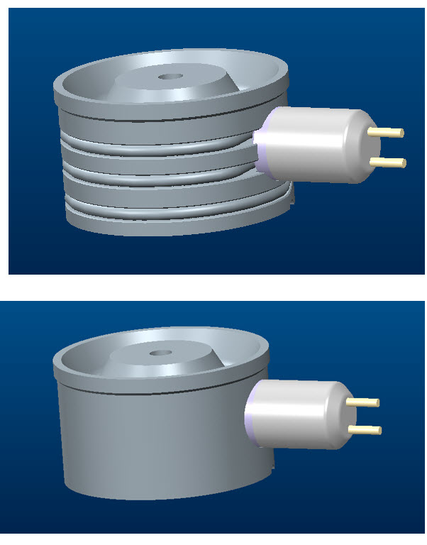

Hi Everybody,
I really need a solution for bellow scenario:
- I have a CAD model with all the details. This model it's used in manufacturing to have proper drawings and models to generate the CNC
- On the other side the customer required to have the models but the Inlectial propely is not supposed to be send to Customer. Some of the models are required to be simplified but not like Shwrinkwrap and filled all the holes or having on block.
Do you have any solution for having one model or assembly with the options of having detail or simplified view?
Thx,
CC
Jun 3, 2014 6:21 PM UTC
That is the purpose of shrinkwrap. Of course, you want to export the file in some other format than the native Creo files.
I have often run into this requirement and I do not find Pro|E to be easy about this. Shrinkwrap has always been a non-intuitive challenge and for the most part, I simply created a model in the assembly using the assembly's references. Depending on the complexity, this can be done in relatively short order with extrudes and revolves. typically, the customer only required critical interfaces and and overall envelope.
Jun 3, 2014 6:41 PM UTC
shrinkwrap usually doesn't work very well:
1. sbould be able to change the models, rotate them when are imported in a different software.
2. most of the time the when shrinkwrap is generate the surface is broken and solid cannot be generated
3. Detailed and simplify should be as a model (having 2 different models is not a good solution). any change should be reflected in both. I know that shrinkwrap is working but having a blok for the entire project is not a solution + it's difficult to simplify them (sometime some holes required to be excluded, some of them no, some other geometry required to be removed sometimes
4. I was tried to use simplify representation but the issue for this when there are features at the assembly level this doesn't work anymore. Havin a simplify representation at the part level is not intersected if the assembly have assembly cuts.
5. Also what we need is teh WT part structure should work properly for BOM.
See some pic. I 'll bring more pics
