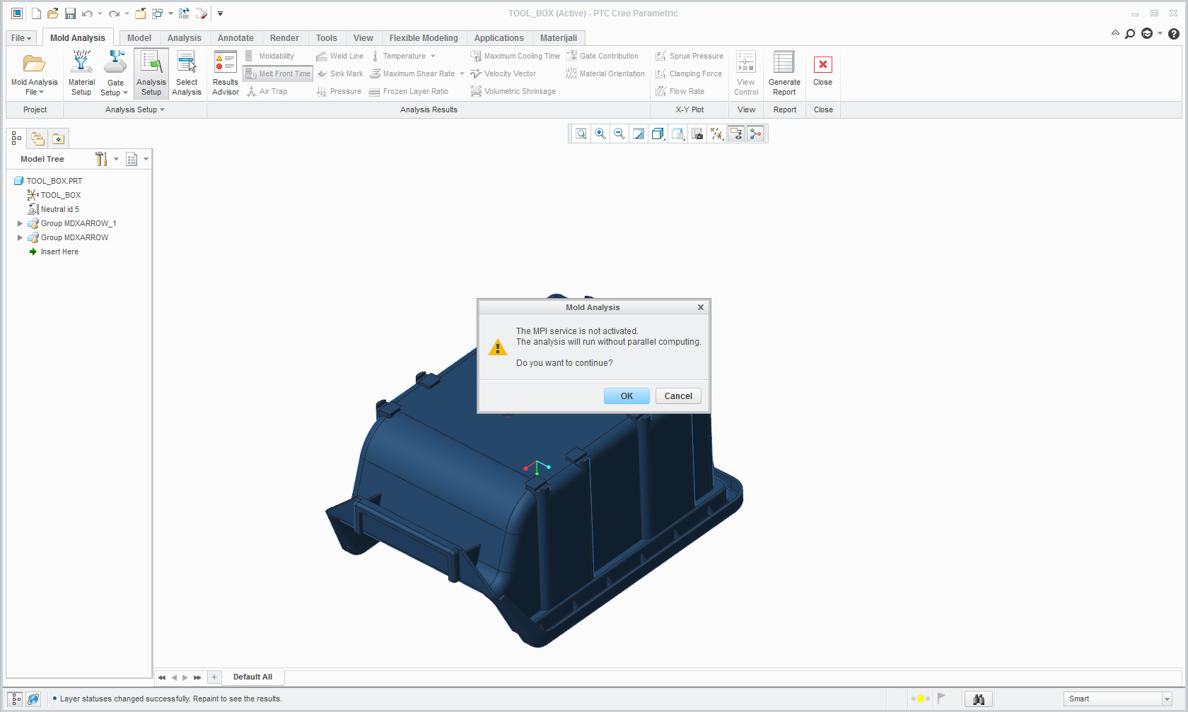

Anyone know how to enable parallel computing for mold analysis extension?
I get this message when runing analysis:

MarcoTosin
Oct 17, 2014 8:30 AM UTC
You have to run ptcsetup.bat and enable distributed services.
When DS are enabled then you can choose which PC can run analysis
Marco
Oct 17, 2014 8:41 AM UTC
DS is enabled 😕
MarcoTosin
Oct 17, 2014 8:46 AM UTC
In your start menu, under PTC can you find PTC Distributed Services --> Distributed Services Manager ?

Davor,
There is an article about this at https://support.ptc.com/appserver/cs/view/solution.jsp?n=CS187138
