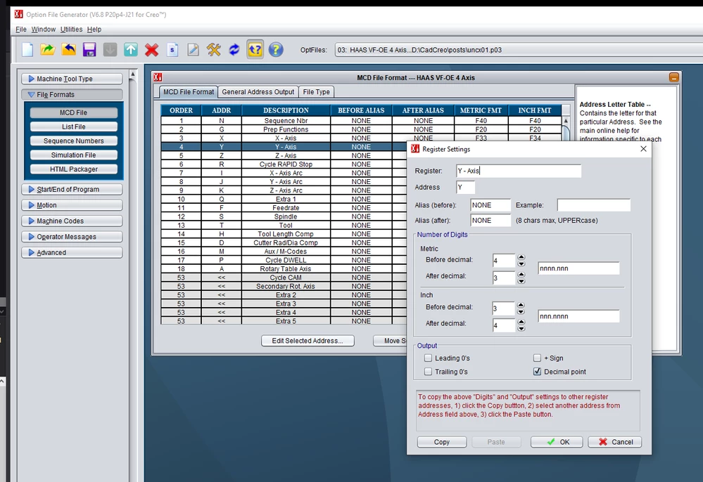

I am having an issue when I post my program using NC post processor (Glidemaster Lathe with Fanuc Control). I am able to post the file but the file is not imputing any decimal points in the program. I have looked under “File Formats” – “General Address Output” but am still not able to get the program to output with decimal points. Additionally, I only have the issue in my Lathe post processor.
If this doesn't help your issue, you might attach your post files (*.pxx and *.fxx) for us to look at.

This fixed it, thank you so much.
