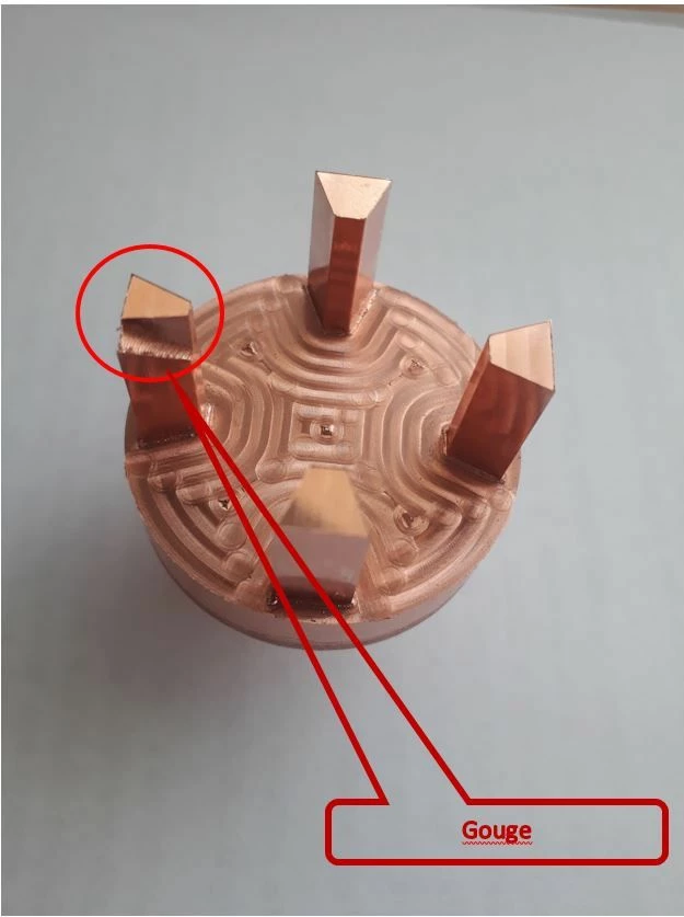

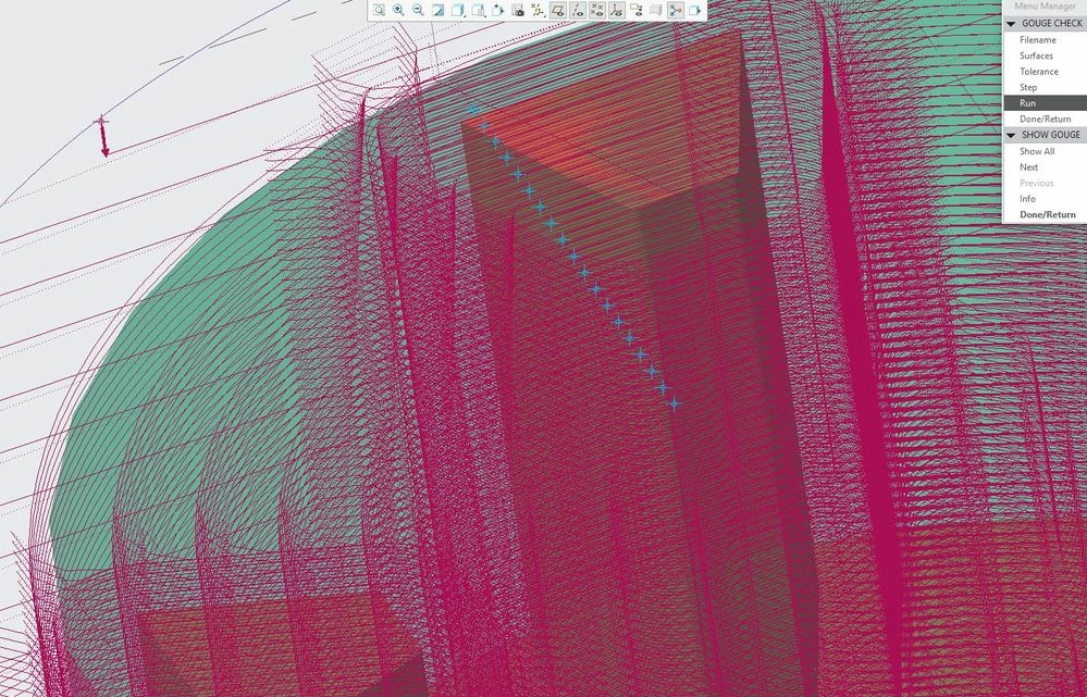

In Creo Parametric 5.0.4.0 not always gouges are found in areas of transition from one NC sequence to another NC sequence. To detect them, it is now necessary to select a specific step value (not tolerance) when checking the CL file for gouges. I propose to improve the CREO functionality for detecting gouges in the CREO (this is not a question of ModuleWorks), irrespective of the gouge check step in the toolpath transition sections from one NC sequence to another NC sequence.Manufacturing resultManufacturing resultGouges check. Step = 0.5Gouges check. Step = 0.5
If step of gouge check = 1 and another, gouges don't found!
