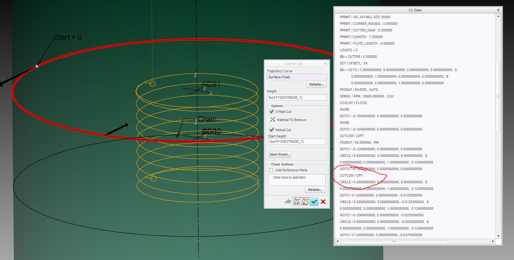

Has anyone else encounter this? The Cutter comp turns off after 1st circle at the top level no way to get it to turn off at the bottom .
I can not understand why it is doing this .
Any Ideas?

The only thing I can think of is to make sure you have a lead in / out set to turn on cutter comp.
I am sure you are aware of this but it doesn't hurt to check.
I assume this is a single point trajectory threadmill.
Steve

Yea Cutcom is set. No this is not thread milling it is just a simply Jaw program to hold a part done in 3 axis Traj mill.
