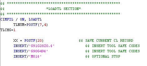

    I have the op stop built into my posts with an insert command in the loadtl section of the fil file so the operator can turn it on or off at the machine. This is all milling macines but I don't know why it wouldn't work for lathes.

    That'll work. I'll see if we can't get an approval on that change.
