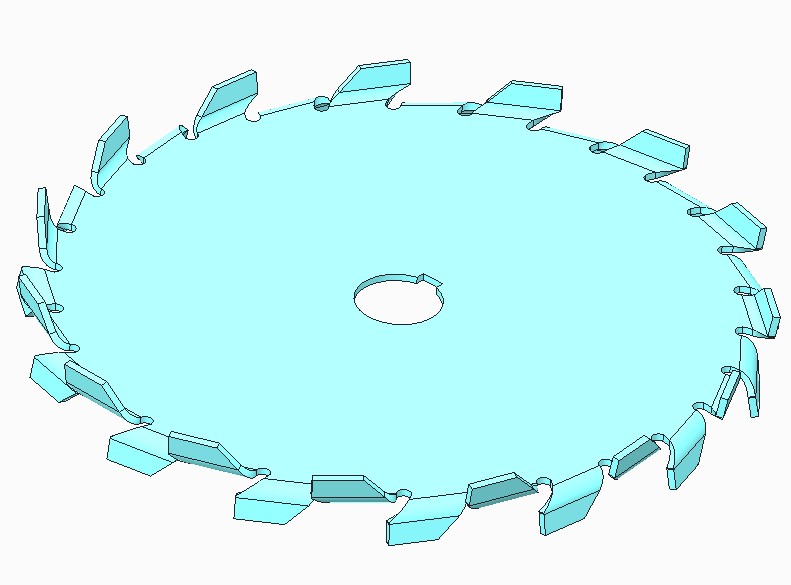

Does anybody know how to create a pattern around the axis in the sheet metal module of Creo Parametric?
I would like to create a pattern of teeth of a bead mill blade but the option which is called "around the axis" is not available (it's grey).

You have to merge the sections of the plate.

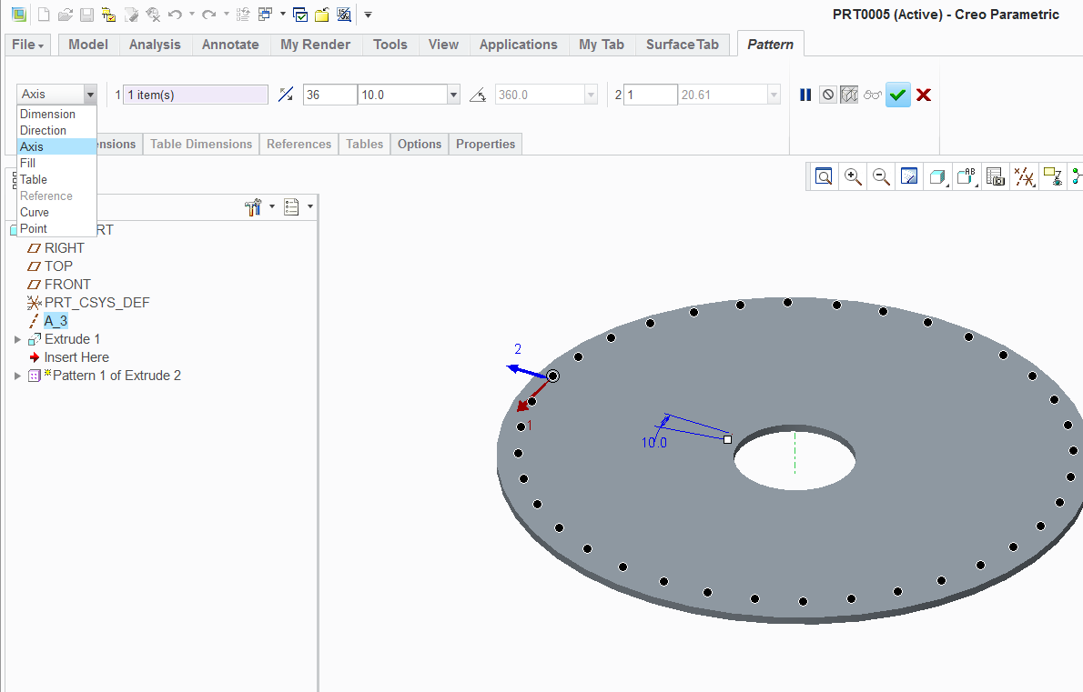

Do you have axis in your part?
This is where you find it...
Sep 17, 2012 5:27 PM UTC
Hello, Antonius!
Thanks for your answer.
Yes, I have the axis in my model and indeed I can make a pattern of holes, cuts and so on around the axis.
But when I try to pattern a bend then this option becomes unavailable.
Sep 17, 2012 5:40 PM UTC
