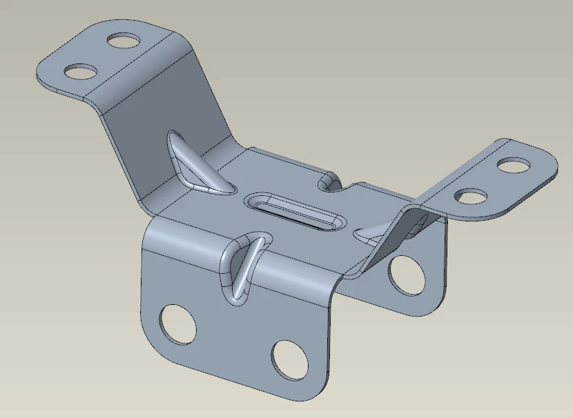

I am trying to make strip from following part with all bendings and punch forms on it.
When I try to prepare or fill article it doesn't flatten punch forms on bends.
The bends with punch forms are also not affected.
Is there any way to do that with punch forms or bends or is there a possibilty to select punch form locations later when doing strip?
I am using CREO 6.0 and PDX 12.0
