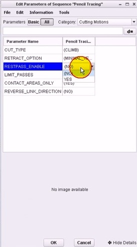

Hello All,
I see pencil tracing mill on the youtube: http://www.youtube.com/watch?v=sC4adYSaaEY
Have some option: ( Restpass_enble )

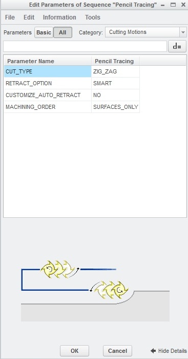

and I made pencil tracing mill but don't have option as above.
I know Pencil tracing mill can run multi pass
I don't know how to use it. Please help ! Thank you.

Have you checked, if you use cut_type climb as in the video?
Sometimes different types anable different parameters.
Also, it seems the reference type is Window - maybe you use a different option to specify the path?
