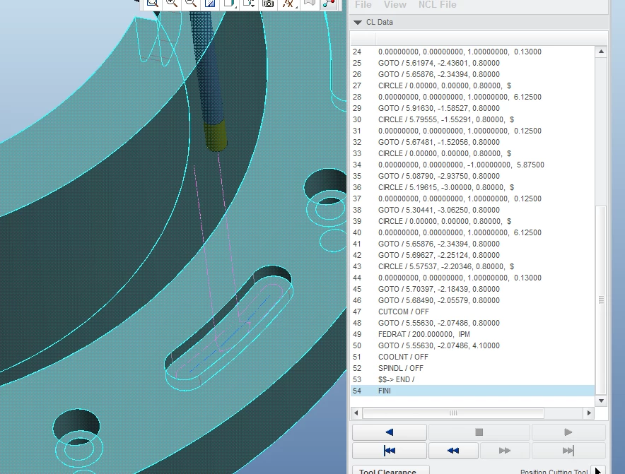

When I am creating a toolpath that is going to be a subroutine I need to have the tool return to the start of the toolpath.
I can create points when no cutter comp is used but when I use cutter comp I am not sure the best way to acheive this.
What would be the best way to return the tool to the start when using cutter comp?
Thank You
Oct 29, 2011 5:42 AM UTC
Try using start - end options from sequence set-up selecting the same datum
point.
