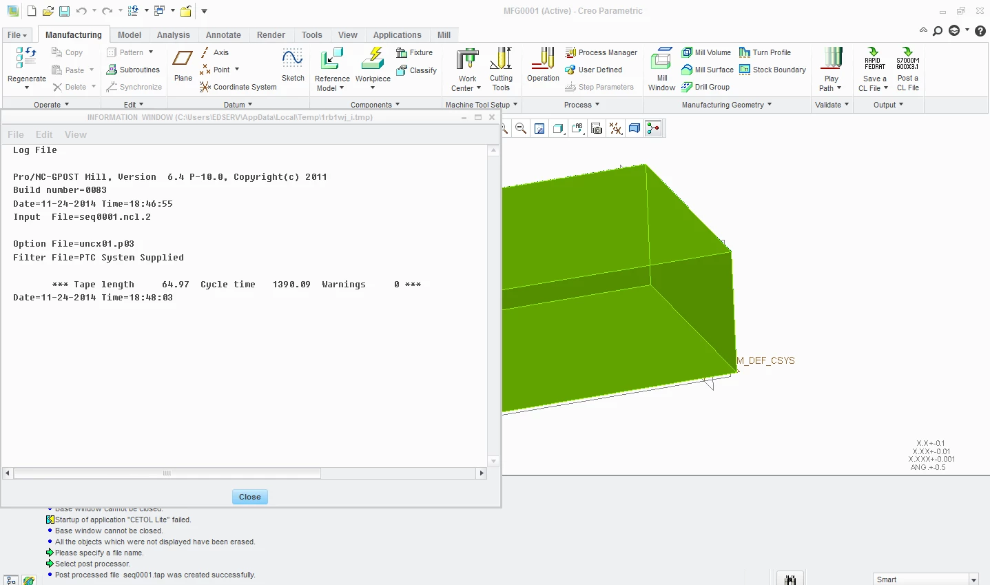

post processing

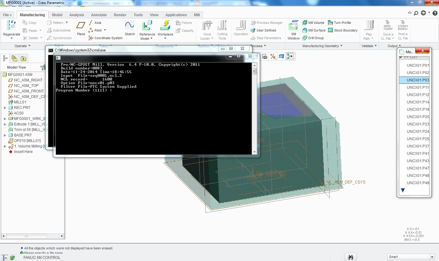

while post processing CL data files using newly created post processor (uncx01.p03) an error occured as shown in attachment.The post processor uncx01.p03 is created by me using existing post processor plz help me to rectify this problem..................
Nov 30, 2014 8:42 AM UTC
By the filter it refer to FIL file which is a basic programming language found it in Gpost.
You don't have one so the system used one by default.
br
Dec 2, 2014 6:34 AM UTC
No. I have FIL editor in option file generator, eventhough I create a new post processor using already existing PP it doesn't works give me an example to work with FIL and option file generator or help me rectify this problem ..........thks for ur reply NANAU

I think you need to properly save uncxXX.fxx and uncxXX.pxx files.
BTW are you able to cuztomize using FIL editor?
