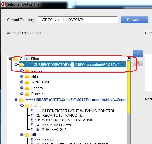

post processor
how to add newly created option file(post processor) to the default postprocessor list plz reply ??? plz help me sir.................

instance of the new in the folder by default
2-Explorer
Feb 9, 2015 4:47 PM UTC
  • Specify the directory with the with the *.p## (e.g. uncx01.p01) and optional *.f## (e.g. uncx01.f01) files by config.pro option gpostpp_dir.
  • Depending on the PP type, you will find them when expanding Lathes, Mills, etc...

is there any common PP in creo for fanuc controller as in mastercam. in mastercam there is common PP for fanuc controller we have to edit the program after post processing a little bit

There is a PP for a FANUC 15M on the postprocessor library available for download. Maybe you can use this as a start point?
Production Postprocessor Library : http://support.ptc.com/cs/cs_27/howto/ncgp4905/ncgp4905.htm
The links at the end of the document refer you to Additional Post Processor Libraries and under Milling you find some more FANUC PPs that you can use and adapt as needed.
