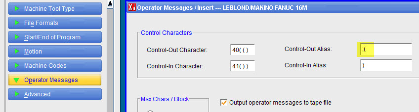

I assume you got rid of G98G80G90G49G17 by editing Start/End of Program > Start Prog.
Maybe you can try to change Control-Out Alias to add the semicolons:
But be aware this will add semicolon before every operator message!
