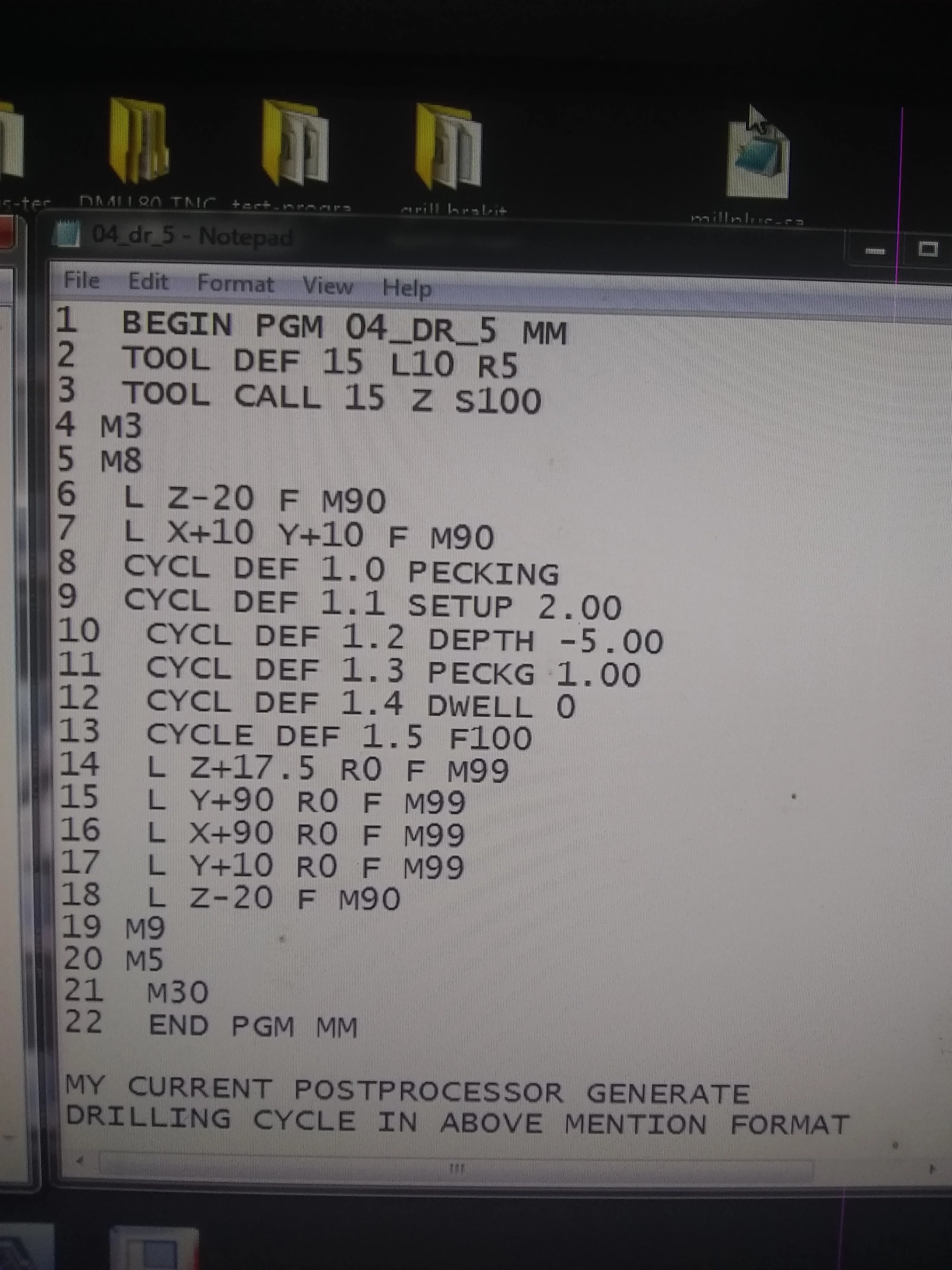

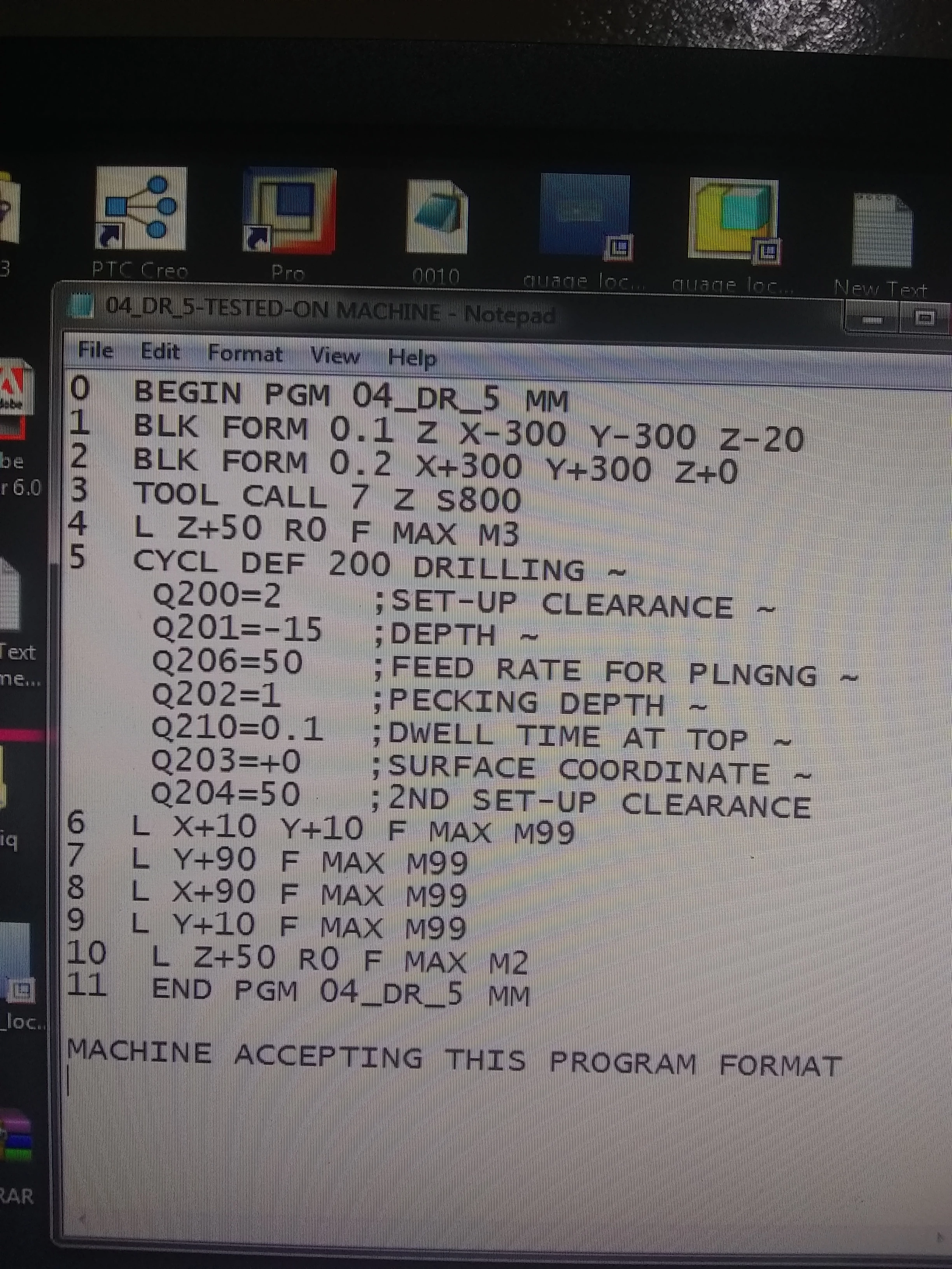

Post processor modify tnc426 Heidenhain
Can someone help me. How to modify pp for desire drilling cycle please check attached jpeg

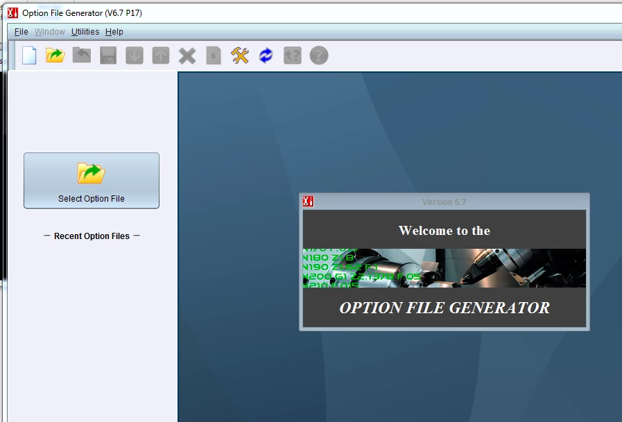

Which post processor generator you use ?
asifcad15-MoonstoneAuthor
Jan 16, 2019 1:27 PM UTC
please check attachment
Jan 16, 2019 3:40 PM UTC
Send the file uncx01.f**, and I show you the changes to be made.
