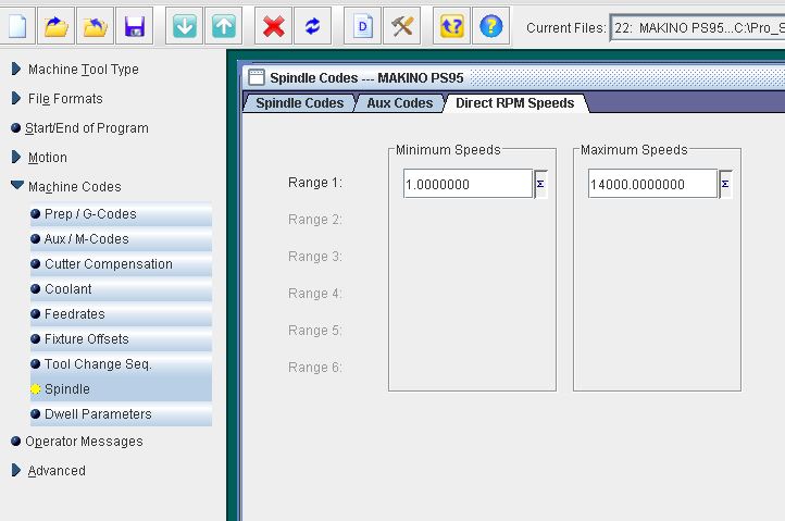

Post won't let RPM go above 10,000
When I post a .ncl file my RPM's won't go beyond 10,000 even if in the paratemers they are at say 25,000. Any ideas how to fix this? Seems like it's a software issue setting???

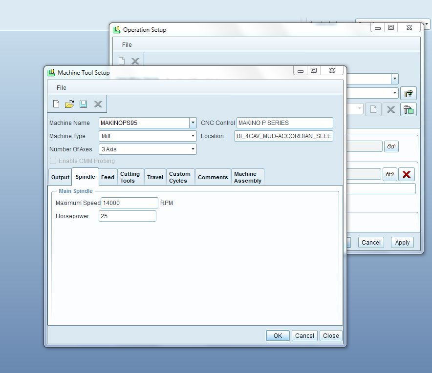

    Jeff,
    are you sure it's a post problem? Iset my maximum rpm in the machine setup. like the picture. you can also set themaximum rpm in the site files also I know you have been using them just wondering if it got set there?rpm.JPG

    If you have GPOST, go to
    Machine Codes
    Spindle
    then the Direct RPM Speeds tab.
    Check the Maximum Speeds
    If that doesn't work there may be something in the fil file that is limiting your speeds

    Thanks guys, AGAIN!!! It needed to be changed in the GPOST as Steve stated. Now we are golden and new machine is running like a top!!!
