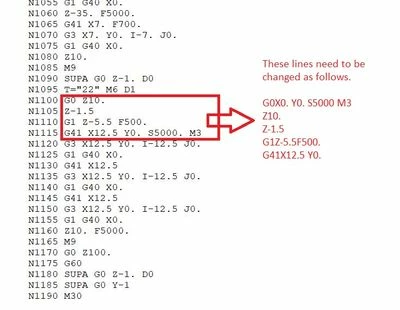

    We have a CNC(DMG M1 with rotary axis) with the same control unit. I looked at the posts in the community and made a processor. I did a few tries on the machine and it worked fine. But there are some problems on the post output. I want to post first X-Y position then Z position line but some times processor doesn't work properly.  I attached the processor files and the picture that shows the problem. İf someone help me to improve this post processor I'd be appreciated.
    Note: Tool_Name must be YES on the PPrint settings
