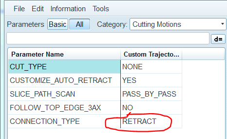

sounds like defalut behavior for Pro E
Here is the option for traj milling
And volume milling

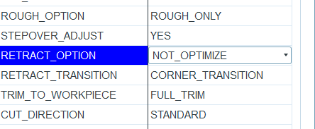

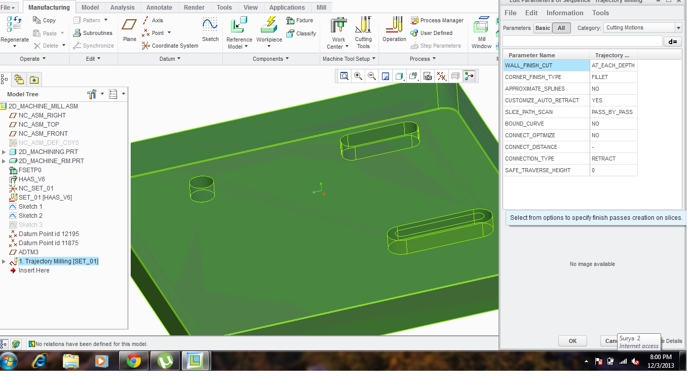

Hi Thanks for your reply.
Still I dont find the anwer I couldnot find your solution in the trajectory milling parameter.
Pls find the image for your refernce .
Pls share parameter list what you have enetered for proe trajectory milling
