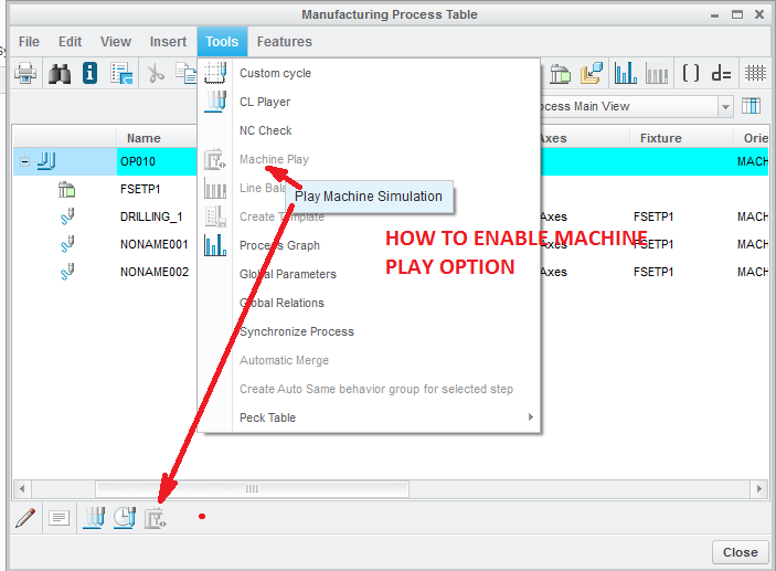

Pro-nc , how to enable machine play option

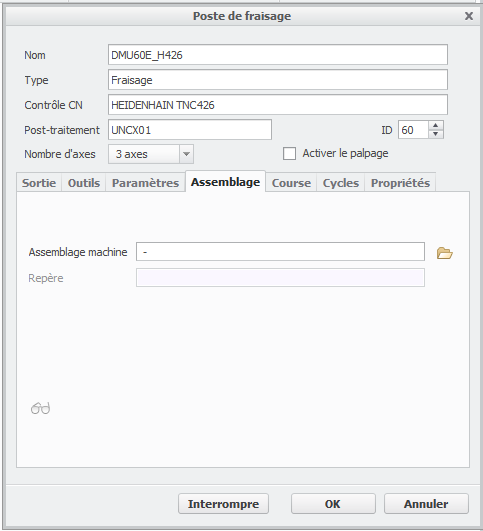

You probably have to define a machine assembly through this window below (definition of the working center):

May 27, 2016 1:24 PM UTC
You must have an assembly corresponding to the machine you use. This is the problem. You have to find one or build it by yourself. If you look to Creo help you will find what constraint you have to respect in order to work correctly.
