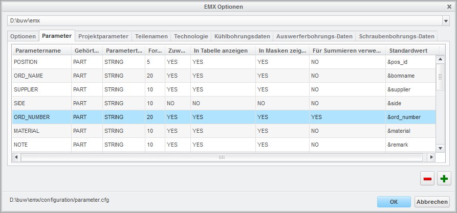

As an example the odering number of a Meusburger guide bushing will be used. The parameter name ORD_NUMBER for this ordering number is specified in EMX Options > Parameter:

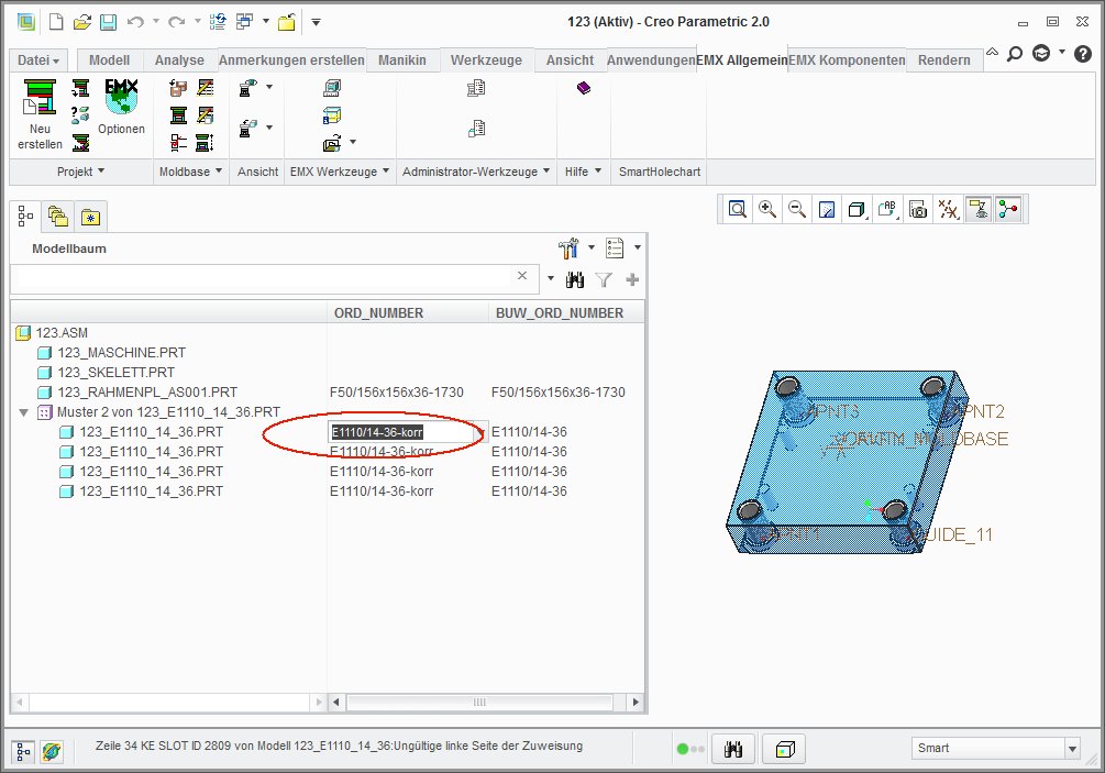

Here you see the paramerter ORD_NUMBER and the component parameter BUW_ORD_NUMBER displayed as extra columns in the modeltree.

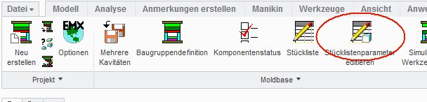

The content of BUW_ORD_NUMBER is maintained by EMX and must not be modified. If you edit the content of ORD_NUMBER now, EMX does not know baout it and will reset the value to the content of BUW_ORD_NUMBER automatically. To avoid this ... use Edit BOM Entry-function instead:

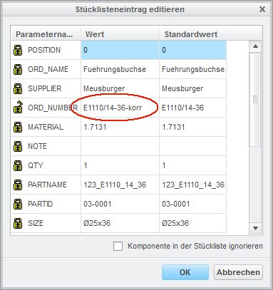

and enter the desired new value in this dialog box:
Doing so, the manually overwritten value will remain during the entire design process!

Now correct me if i'm wrong but by using EDIT BOM entry-function we are modifying this particular component parameter value. This means that while in the part we have the 4 guide bushings with the same modified value, but when we enter the EMX BOM we'll have 3+1 quantity. Correct?

it depends on which parameters you have chosen to be used as "seperator" for the EMX BOM. In the example shown above I use the content of &ord_number-Parameter only for summarizing the models in the BOM. So here all four bushings will appear in one line! Its a pattern of four models ... so it cant be seperated.
For the typical 3+1-guidesets ... you would find a bushing pattern with 3 members and one with one member.
