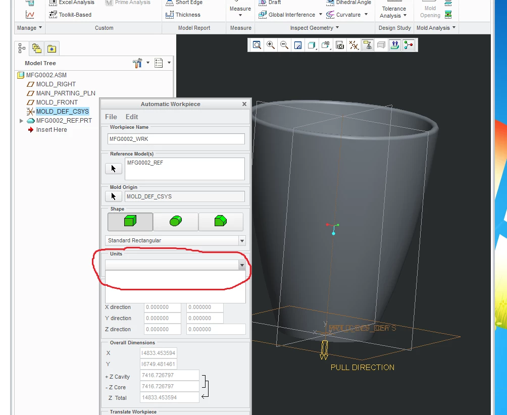

Hello guys,
I have quite a trouble with Automatic Workpiece in Mold Cavity. I just cant choose any units in offsets. I have no idea why. I did some googling but couldnt find anything usefull. Do you have any advice? Thank you very much.

Mine is that way, too. But I never use automatic (had to try it and see). Are on you on build m070?
Sep 26, 2013 10:02 PM UTC
You guys didn't install "mold component catlog" under option
Sep 26, 2013 10:43 PM UTC
Oh good call. Just got my key this week, so should go do that...Maybe that will fix my runner issue.
Sep 26, 2013 10:52 PM UTC
Yup that was it. Had to have the catalog installed.

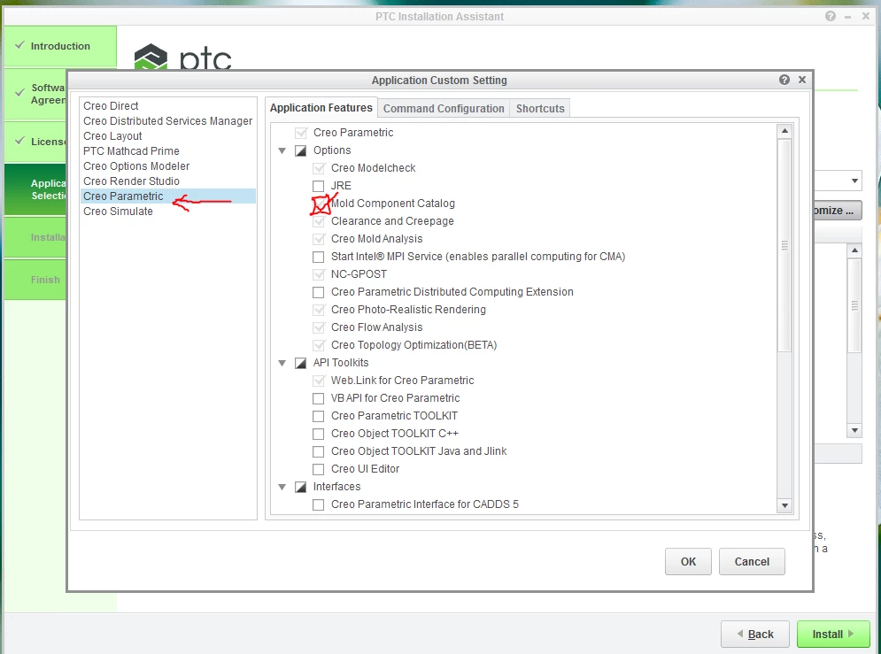

Jul 2, 2018 2:21 PM UTC
I am also having this problem in Creo 4.0.

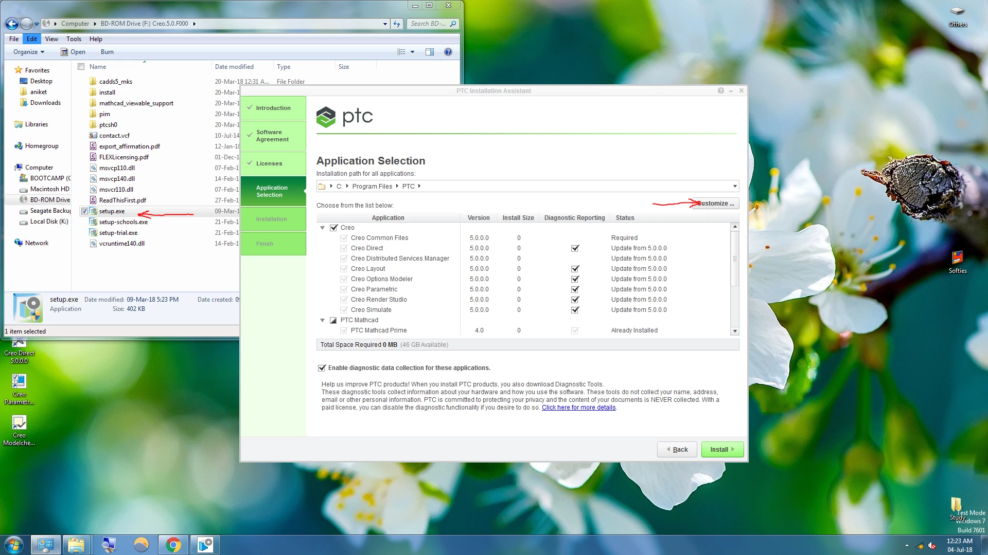

Jul 3, 2018 6:58 PM UTC
Run setup.exe.
Select "Upgrade existing software".
Next
I Accept Agrrements (and all).
Next
Select License file if it's not there.
Next
In "Application Selection " Tab, click on 'Customize'.
Go to Creo Parametric tab
In right side, drop down "Option"
Select "Mold Component Catalogue"
Ok.
Complete the following setup.
Your Problem must be solved.
If not, send me message.
