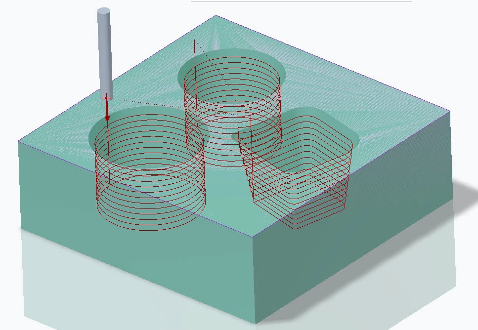

Profile machining my biggest Pet Peeve
Does anyone know what parameters will make the tool continue on all the way the toolpath rather than after each cut tool will  exit to retract plane each time?.
Apr 28, 2021 9:58 PM UTC
You should use the Volume Milling toolpath, with the ROUGH_OPTION set to PROFILE_ONLY.  This should have all the same options as the Profile toolpath but is set by default to machine each “region” as you prefer.  It is also faster to set up if you have lots of pockets, since you can simply use a Mill Window that encompasses them all.
I would also note that holes can be milled in a single helical cut using Trajectory, while complex pockets could also be done helically with Cut Line Machining.

Have you tried changing connection_type to simultaneous?
