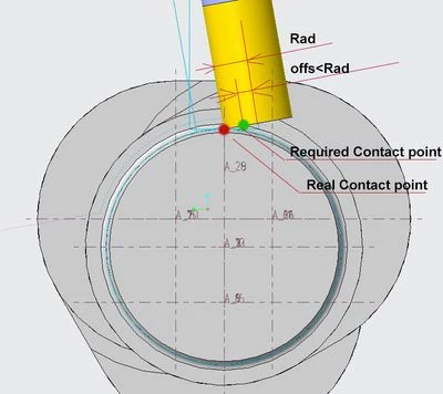

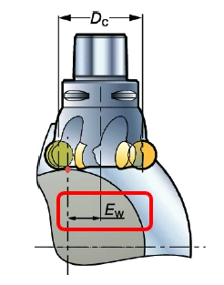

To obtain scallops of optimal height, it is necessary to shift the center of the cutter tool relative to the axis of the workpiece.
In other words, we need to ensure a offset of the cutter axis relative to the workpiece axis (Ew).
We tried to do this using the 4X_LEAD_ANGLE angle, but we realized that the Ew offset and the 4X_LEAD_ANGLE angle are different and independent values. That is, it is impossible to obtain a certain offset Ew simply by changing the angle 4X_LEAD_ANGLE, and vice versa.
Moreover, the contact point of the “END MILL” tool with values ​​of 4X_LEAD_ANGLE is more than 1 deg. from the center of the tool face, when 4X_LEAD_ANGLE is close to zero, immediately moves to a point at a distance of the tool radius.
It is not yet possible (CREO 10) to obtain an offset at a distance less than the tool radius:
How, for example, can you machine an elliptical section of a shaft with the “END MILL” tool offset?
