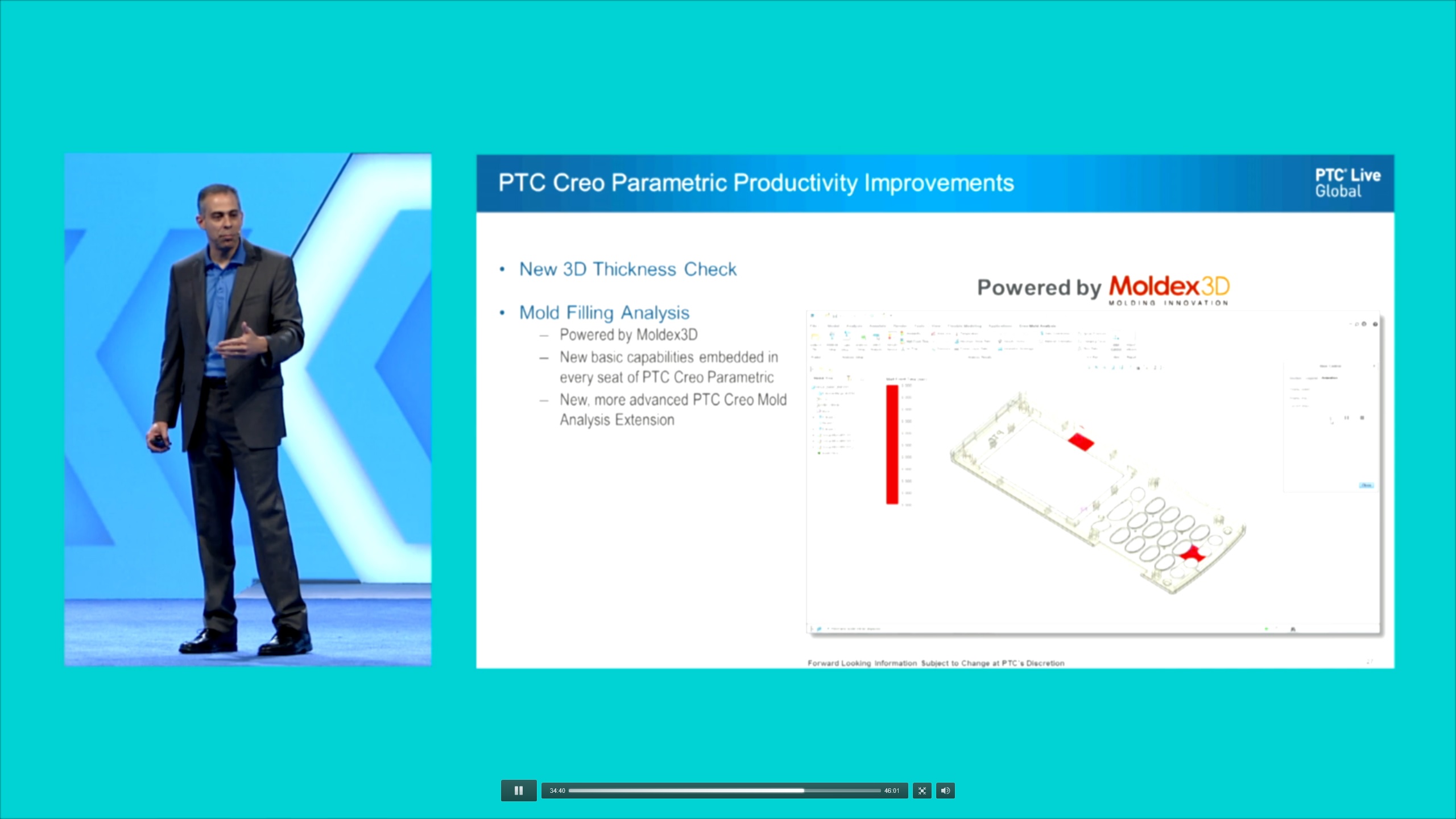

Dear All,
In PTC Creo 3.0 Launch Presentation from June 17, 2014 Brian Thomson announced that New basic capabilities from Moldex 3d will be embedded in every seat of Creo Parametric. I have installed Creo 3.0 M10 and there is no such analysis. Only what i can access is 3d thickness Check. I was told that i need to buy PTC Creo Mold Analysis Extension, why if they said in every seat?. Please check PTC Creo 3.0 Launch Presentation at time 34:28 Where Brian Thomson said " every body gets it". I was rely looking forward of this functionality. Did i missed something? Can someone give me answer please.
Best Regards
Klemen

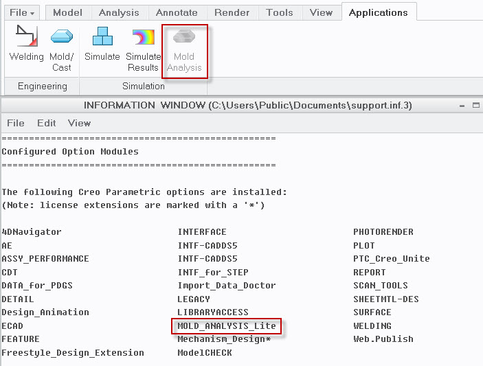

Nov 4, 2014 10:22 PM UTC
Hi Klemen,
Yes, this became available with Creo 3.0 M010, but there is an additional requirement that you need to update your license pack.
There is a new license pack line item called Mold Analysis Lite that PTC should be adding to every customer's license pack automatically (for those on support).
All the details are here: https://support.ptc.com/appserver/cs/view/solution.jsp?n=CS187881

kerzen10-MarbleAuthorAnswer
Nov 7, 2014 7:38 AM UTC
Hi, there is some update on this issue
First; You need to upgrade your licence for free to enable Mold Analysis Lite.
Second; When you do that you get enabled Mold Analysis Lite
Third; What is enabled in Mold Analysis Lite is useless.
Hope that in future Lite versions will be more useful.
Best Regards
Klemen
Nov 26, 2014 4:19 AM UTC
Isn't it supposed to be available via Applications- Mold Analysis? Mine is still greyed out even though the Mold Anaysis Lite is shown in System information under configured license options.
