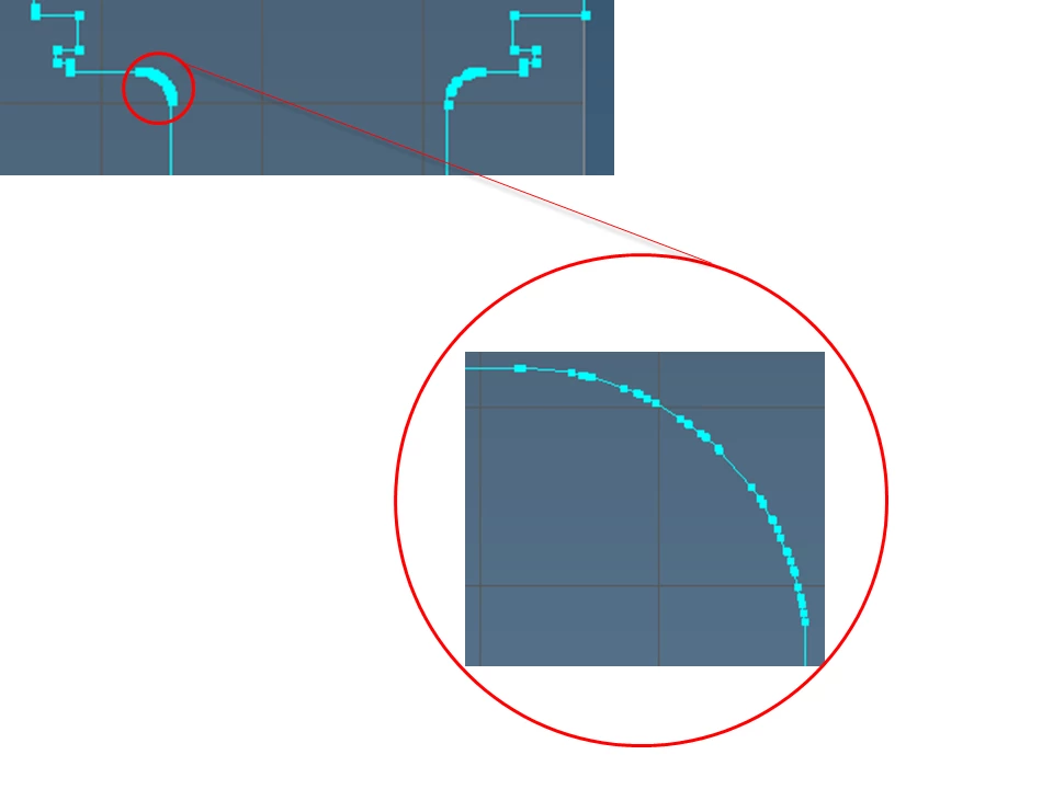

My company has just recently started using solid models to create machining programs in GibbsCAM. We are experiencing issues with radii where there are more points in the radius than the standard 3 points (start, midpoint, end). Has anyone else had this issue and if so have you found a solution.
Sep 1, 2012 1:39 PM UTC
Or the export-import process converted the circles into curves, or the originating CAD-system represents circles as a special case of curves.
