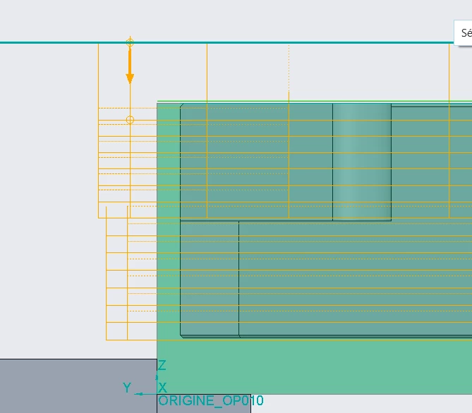

Ramping on constant load rough
Every time i select "constant load" on a rough sequence, Creo add a at the start of each trajectory a ramping. It is not a correct arc but a succession of straight segments. The huge problem is that in practice, during machining my milling machine moves jerkily and vibrates enormously to follow all the segments. With other types of scanning, i do not have this problem, the cut start on the right Z position.
(Volume milling with cst load option = same problem)

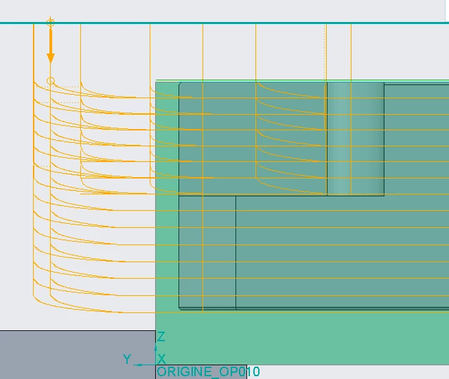

Rough with cst load :
Rough with "Follow contour or spiral"
Any idea to remove this "ramping" ?
Thanks in advance.

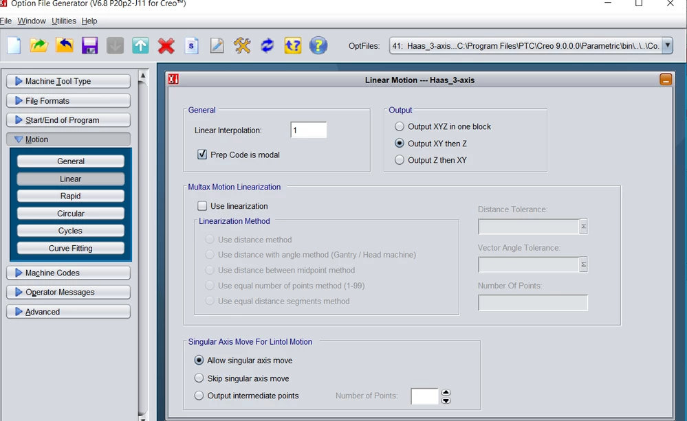

Haas control, i try G187P1, it works a little bit better. And i found an other problem in my code. The post processor output X & Y moves in on block and Z in another. With micro segments it could be the cause of the vibration problem.
I have solve this with the first option in the postpro : one block for X,Y & Z

Dec 24, 2022 5:30 PM UTC
Please specify which version of the program you are using.
RJ_FR12-AmethystAuthor
Dec 24, 2022 6:15 PM UTC
Creo 9.0.0.0

Jan 2, 2023 7:12 PM UTC
Which control does your machine use?  I had this issue on a HAAS and was able to correct it by using "G187 P1" so that the control would smooth the motion.  I also had to use a correct tolerance setting, like bmuller suggested.
Alternatively, it might help to adjust the "ramp angle" parameter.
RJ_FR12-AmethystAuthorAnswer
Jan 12, 2023 7:16 AM UTC
