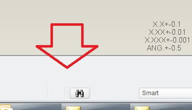

Oct 11, 2013 8:01 PM UTC
Has anyone found a resultion to this? I have the same problem with regen in MFG assm and others.
Also there is no regen status on screen (lower right).
