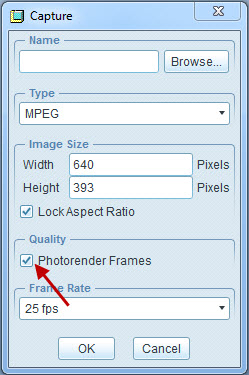

Frank,
Yes, you can apply render to animations.  Set up your render environment (scene, lights, etc.) prior to capturing your animation, then select Photorender Frames before initiating the capture. Depending on your settings and your hardware, it can take some time ( I have left my computer running all night for some), but the results can be worth it.Capture.jpg Video Link : 4860
