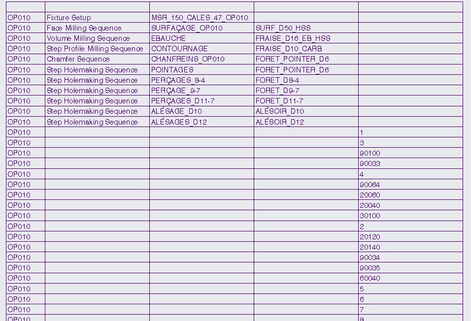

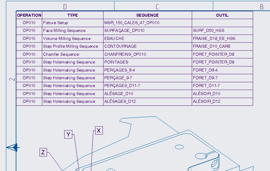

On my manufacturing draws, i have a sheet for each operation (op010, 020, 030 etc.)
On each sheet i have a repeat region with all sequences type, name and tool for the actual operation.
I order to simplify the operatior work, i would like to add a fifth column with the tool_pocket_number for loading the tool carousel on the machine with the right tool.

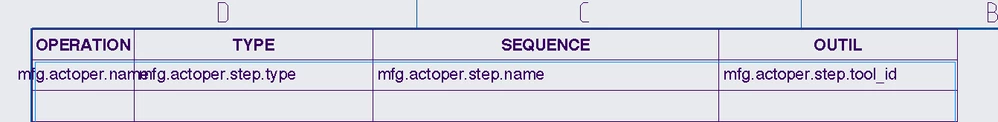

Here are my column parameters :
When i add &mfg.actoper.workcell.head.tooltbl.toolpocket.tool_position in the fifth column here is what i get :
How can i add for each line the tool pocket number ?
Thanks in advance.

Dec 12, 2022 8:19 AM UTC
your description is missing an image showing which cell you inserted the &mfg.actoper.workcell.head.tooltbl.toolpocket.tool_position parameter into.
Dec 12, 2022 8:38 AM UTC
... it would be helpful if you could upload the test data

With &mfg.actoper.step.pocket_number it works !
