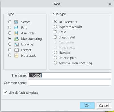

Dear Admin,
In PTC Creo, the "Mold Cavity" and "Cast Cavity" option are
disabled in the Manufacturing module. How could I enable this feature.
Best regards,
Shahid Iqbal
Fig : Shown as Grayed outFig : Shown as Grayed out

From a quick search, how you purchased the expert Mold Cavity Extension of Creo? Are you running the basic design package?

Well, I think I have not purchased the extension separately. It's Academic Edition version 11 (Student version)
