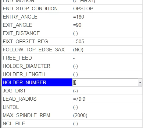

Mar 8, 2016 7:55 PM UTC
Bobby,
The following information is copied from the NC Manufacturing help file:
"Automatic Tool Attachment
Tool attachment is an assembly of a tool and an attachment. The tool and the attachment can be part models or subassemblies.
When a tool attachment is used in an NC sequence, you can use the TOOL_ATTCHMENT parameter for NC Manufacturing to identify the attachment from the tool attachment assembly. You can specify the TOOL_ATTCHMENT parameter while defining or modifying a part or subassembly. The possible values for the TOOL_ATTCHMENT parameter are YES and NO. For the attachment part or assembly the value must be set to YES.
While defining an NC sequence, NC Manufacturing identifies the attachment part or assembly by the value of the TOOL_ATTCHMENT parameter. This part or assembly is then automatically used as the attachment for the NC sequence.
TOOLING LIBRARY Catalog
To Create a Tool Attachment
Create a new Pro/ENGINEER model of type Part or Assembly. Assign the name of the attachment to this part or assembly. Reproduce the geometry of the attachment by using the appropriate construction features (protrusions, cuts, and so on). This geometric representation can be as accurate or as simplified as you wish.
Create a coordinate system to define the holder orientation on the machine, and change the name of the coordinate system to SPINDLE_CONTROL_POINT. When you use the attachment, the z-axis of the SPINDLE_CONTROL_POINT coordinate system is aligned with the z-axis of the Machine coordinate system.
Create a second coordinate system, which provides the tool orientation and is used to attach the tool. Change the name of the coordinate system to TOOL_ATTACH_POINT. When you use the attachment, the z-axis of the TOOL_ATTACH_POINT coordinate system is aligned with the z-axis of the NC sequence coordinate system. If you use a solid tool model, you must define an additional coordinate system named ATTACHMENT in the tool model, and NC Manufacturing attaches the tool by aligning this coordinate system with the TOOL_ATTACH_POINT coordinate system of the attachment. If the ATTACHMENT coordinate system is not defined in a solid tool, NC Manufacturing uses the TIP coordinate system in its place. If you use a parameter-driven tool, NC Manufacturing attaches the top end of the tool to the TOOL_ATTACH_POINT coordinate system.
Add to the model a parameter with the name ATTACHMENT_NUMBER, type Integer, and value corresponding to the holder identification number. This value is used for CL output.
Save the model."
Note that you must specify the attachment number in the machining sequence, either by relation like so: "HOLDER_NUMBER = 3" or directly in the parameters page (see attachment).
If you create a solid model of the attachment, it can be displayed during 'PLAY PATH' by specifying the model name in Setup 'Attachment', or in the Options | Cutting Tool Adapter dialog of the collector.
Remove the attachment model before posting; it creates CL file entities that your post may not handle.
Lastly, you must have a post-processor that's set up to handle the attachment(s), otherwise, you'll get 'funny' output.
