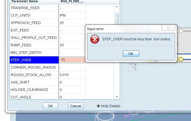

Roughing cutter width of cut?
have a couple of high feed inserted end mills that say I can use up to the full cutter width for cutting, But using the roughing sequence in Pro/Manufacturing will only let you less than half the cutter width for a step over value. anyone have a work around for this issue? I don't know why they would limit you only less than half the cutter.

Apr 23, 2012 3:15 PM UTC
I also dislike this limitation. The only way around it that I have found is using volume roughing

May 4, 2012 1:22 PM UTC
Hello Steve
I often use the roughing sequence and I think that your limitation is due to the fact that you use CONSTANT_LOAD for the OPEN_AREA_SCAN and CLOSED_AREA_SCAN. You can change it to TYPE_SPIRAL or FOLLOW_CONTOUR and you will be able to use more than the tool radius.
I hope this helps you
Olivier COUPAT
May 4, 2012 1:39 PM UTC
I think this might depend on which version / date code your running.

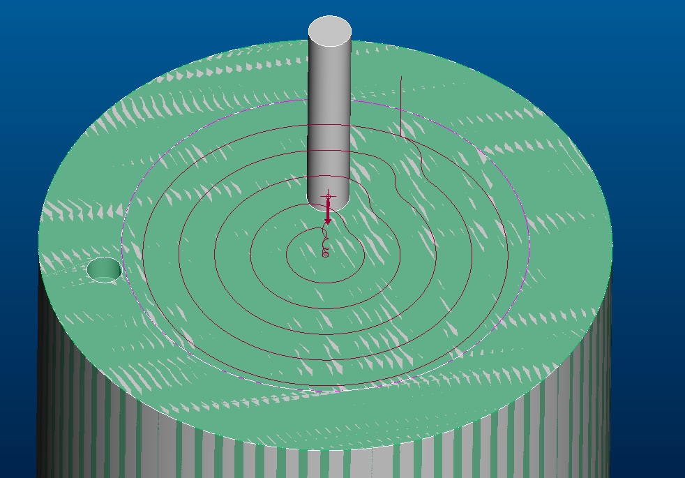

May 4, 2012 1:50 PM UTC
We actually use Creo element Pro 5 datecode M120 but I use this option till Wildifire 3.
Here is the result with end mil of diameter 3 mm and STEP_OVER of 2.5 mm and FOLLOW_CONTOUR type
