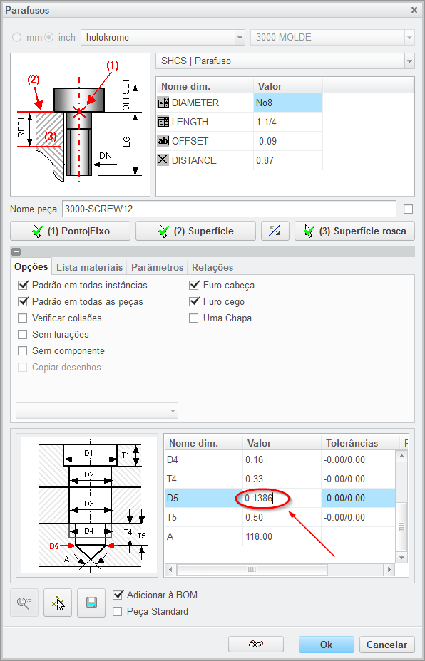

How can I change the default accuracy of the screws to four digits?

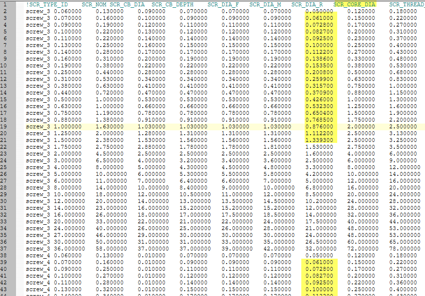

I have already change the values in  "\EMX80_M021_PT\configuration\bore_screw.cfg"   but inserting the screws these values are rounded up.
January 25, 2017
I found it: option "NR_DIGITS_COMMON"=4.
