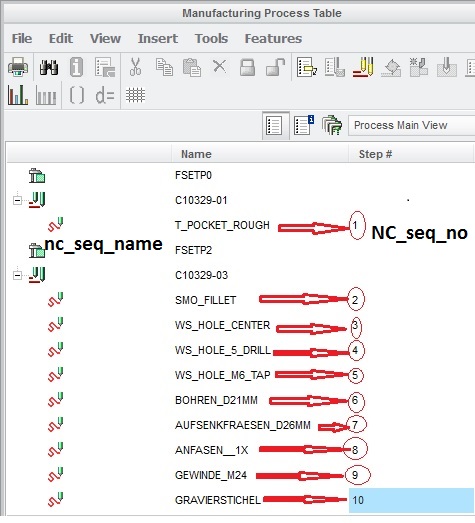

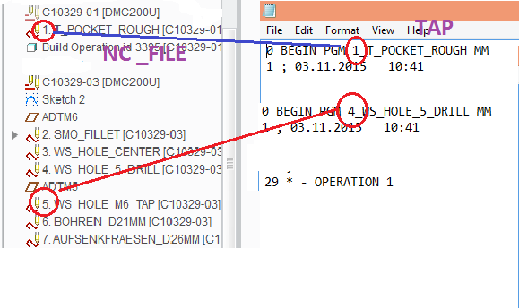

How to add SEQUENCE NUMBER   SHOULD BE IN HEADER in  post processor  Heainden 5 axis.

Hello T Shiva Kumar,
I don't see a way, how you could do this.
The sequence number is not added to CLDATA (not by default and no PPRINT setting either), so there is no way for the PP to extract it.
It is an unusual wish anyway, as sequence numbers, similar to feature numbers are not fix - they always depend on the order and what features are suppressed/resumed.
I rather recommend to name your sequences accordingly, e.g. 1_T_POCKET_ROUGH
This is the answer, assuming you do not just want to have just the sequences in the post numbered, always starting with one and increasing by one.
If you desire the latter, you could just use a count in the PP (e.g. counting $$-> FEATNO lines) and prepend the number by INSERT command for each sequence name.
Gunter

Dear koch,
  Here I am showing Step# Column in image.
  I am not getting  this column value in PPRINT or  PARAMETER UI.
  regarding this please give any suggestion.
