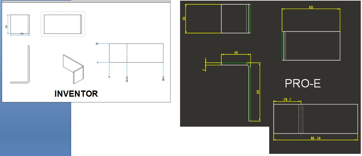

Please find attached an example. A sheet metal part of dimensions 30*60*2. I have attached flat state views of both inventor and PRO-E for reference.
Jun 9, 2014 4:45 AM UTC
Jun 9, 2014 4:47 AM UTC
The flat state length generated in Inventor is 86.5 and 83.39 in PRO-E . (Dimensions in "MM")

Shibin,
I can see different value on the picture...
Inventor is 86.5 and ProE is 86.39 mm ... the difference is 0.11 mm
