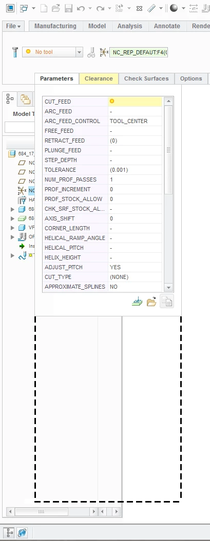

In Creo NC, using Machine Tool Setup -> Parameter UI, I have edited the list of basic parameters visible in the "Parameters" list of NC sequence edition.
Because it's quite a long list of basic parameters that I now have, I'm wondering if it's possible to customize the default size of the "Parameters" dropdown window in order to extend it downwards. See attached screenshot for visual.
I prefer having a tall "Parameters" dropdown window rather than having to scroll the list to see all my basic parameters at once.
Any pointers much appreciated.

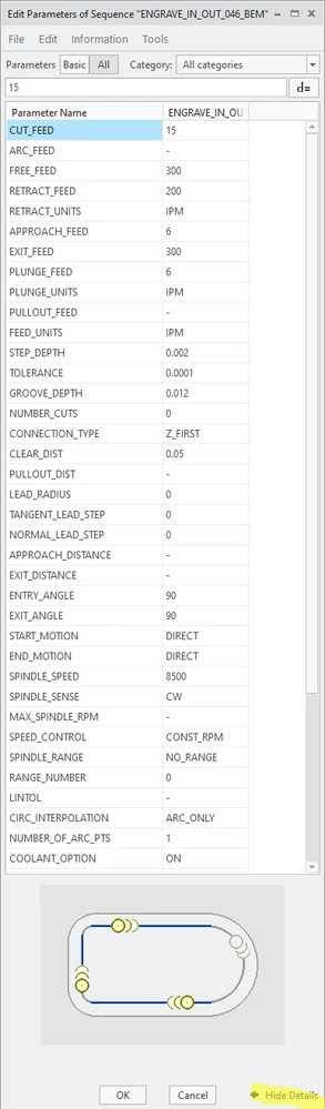

As of now no option to expand the list.. you need to use "Edit Step parameters" to pullout the parameters list.
I think, you can submit an idea for the same.

I would like to see the parameter list expanded automatically even when you do use the "edit step parameter" method. I would also like to be able to hide the "details" check box permanently. After using the sequence more than once or twice the details become a nuisance taking up parameter space
