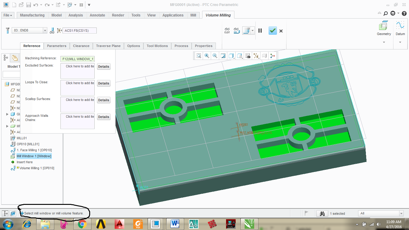

Help me!
Why It's still ask about milling window while I've picked it out and I can't simmulate! ( I'm using roughing voulume)
pgf5451-VisitorAuthor
Apr 27, 2016 5:59 PM UTC
I can't tell from your picture where is your window? Are you trying to select the green areas? Might try to use sketch and draw the window manually instead of letting Creo pick it. Can you give me some more information?
Apr 28, 2016 3:04 AM UTC
I've drawn manually a mill window and I've picked it out.... It's green line not green plane as show in that picture...Can u help me ? tks in advanced
( I want to manufacture some holes like green position)

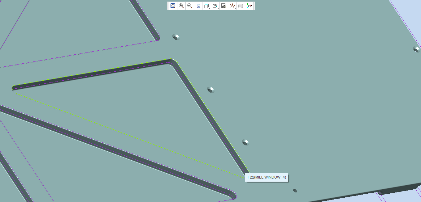

Apr 28, 2016 11:33 AM UTC
Looks like you have the window to the extents of the part. I would build a window that goes around the features that you want to cut. Here is an example of a part I am running now. Also you might need to set the depth in the window setup and check the parameters to make sure you are not missing anything.
Apr 28, 2016 3:31 PM UTC
That's so great. I can do that by projecting and fill the parameters out. really thanks Can we make friends?
