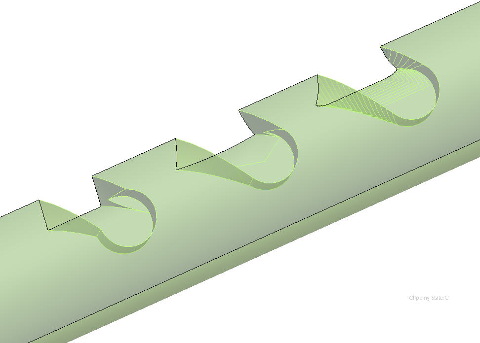

Certainly, for endmills cutting slots into flat plates (flat, ball, dovetail, profile) this functionality could be easily achieved. To do it now you have to do the trajectory sweep followed by revolves at each end. I have referred to this functionality as "swept revolve" in the past, and, since so many real solid parts are manufactured this way, it would be wonderful to have an "endmill" feature.
However, the plot thickens in two respects: (1) as soon as you are cutting with any more complexity than a flat trajectory the geometry gets highly complex instantly (see my screen shot of a grooved barrel cam in the above post), and (2) folks at PTC, fully aware of this desire amongst users, generalize the idea even further to "swept solid", meaning that the geometry is not necessarily the result of rotation of a fixed section around a centerline. This would include operations like gear hobbing with a non-rotating tool.

Jun 26, 2011 11:10 PM UTC
This is the illustration; the slot on the right is what is actually generated by an endmill and required for a cylindrical follower.
