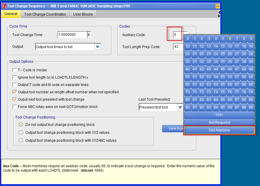

T-Code is Modal still outputs an M06
I and setting up a post for a Leadwell V-60i and need to set the Tool as modal. When I set this option in the Tool Change Sequence output options to "T-code is modal" it will stop posting the T code but still posts an M06.
How can I set up my post not to post an M06 when the T code is modal?

mrego1-VisitorAuthor
Mar 3, 2017 2:06 PM UTC
Thanks Kenneth,
I tried that FIL code but it still posts out the M06.
See example of post below.
G01 Z.1 F196.
M48
M05
G0 G17 G20 G40 G49 G69 G94
M06        <- This is what I need removed when the post is set to T-Code is modal
G54 G90
MIke

Mar 10, 2017 8:09 AM UTC
Hello~~
I think you need to select "Not Available" in "Auxiliary Code" then M06 code not generate.
Have a good day!!
Mark Rao
