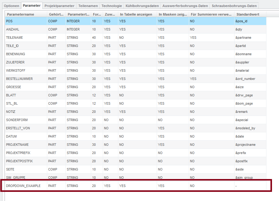

1.  Set up an example parameter in EMX Options with a name DROPDOWN_EXAMPLE and make sure it is aof type STRING and Show in Table and Show in Dialog is e set to YES

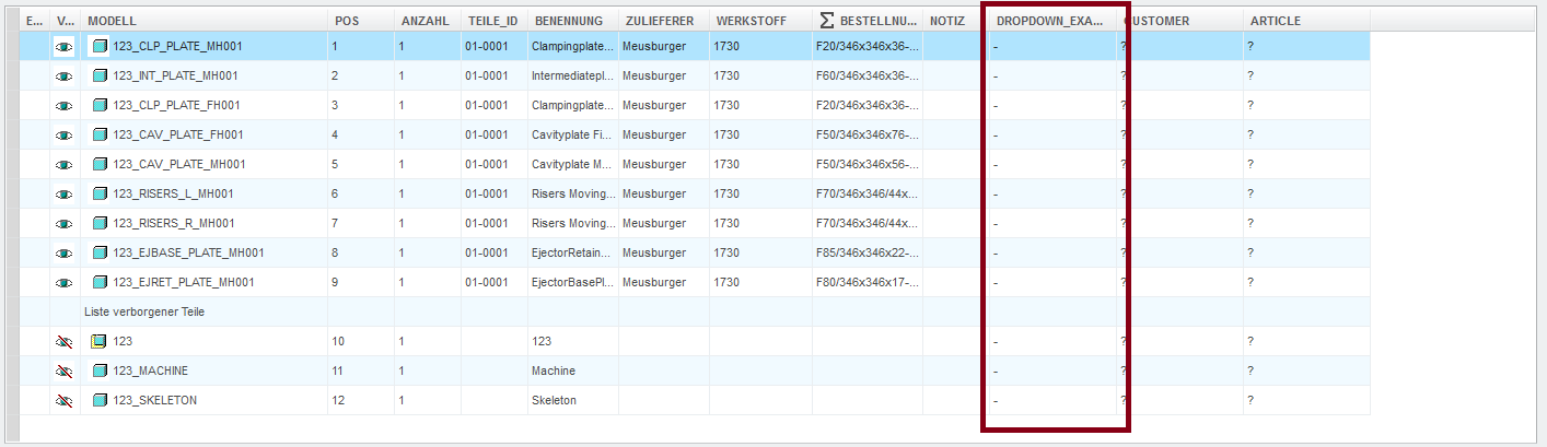

2. Create a new project and assemble a couple of components. Opoen the BOM Dialog. The parameter is added to all Components.

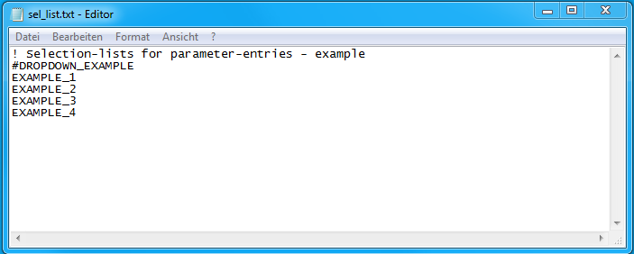

3. Now go to the <emx_install>/configuration folder and find the file sel_list.txt and open it with an text editor. Change the content as seen below. It is important to add a # hastag in front of the parameter name. the following lines will be the list values.In this case EXAMPLE_1, EXAMPLE_2 etc.

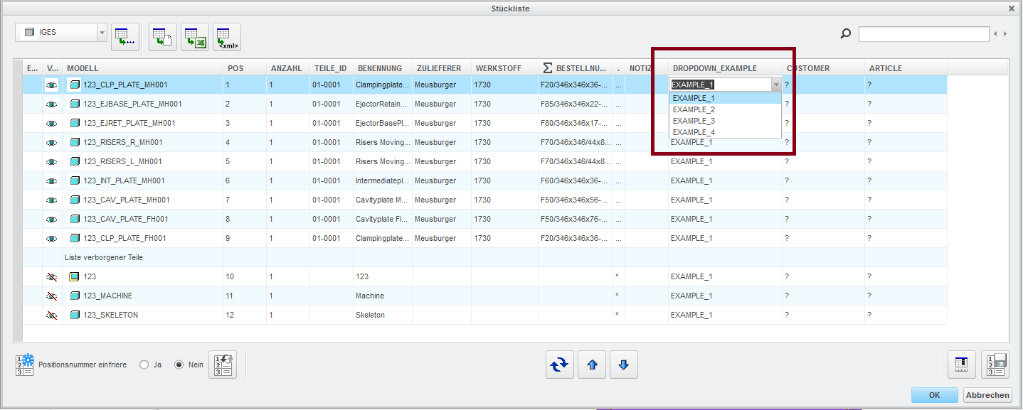

4. Save your project and restart EMX now. If you open your project and got to the BOM Dialog again and doube-click within a DROPDOWN_EXAMPLE cell you will find the list of values available.

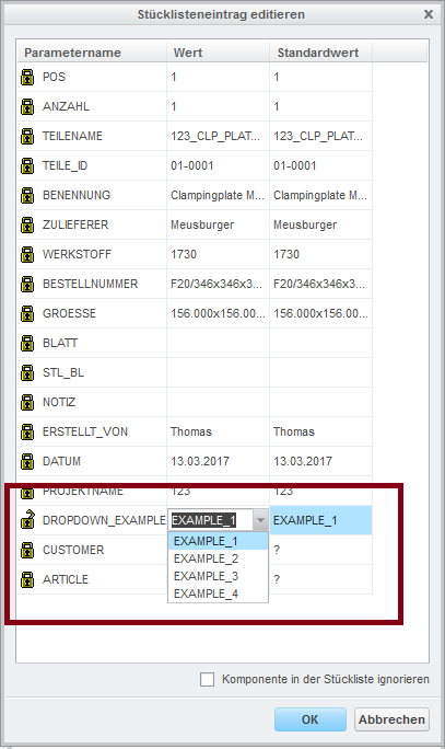

and the same happens in the Edit BOM Entry Dialog box.
