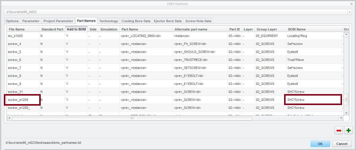

If you open the EMX Options icon_options.png  an switch to the tab Part Names you will find a table with all templates use for EMX components.
In my example the BOM Name for the template file screw_e1200 is called SHC*Screw. The * will later be replateced with a space character.
In this dialog you can set up any kind of description that you need for your mold.

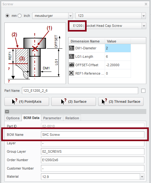

If we now open the Screw dialog and switch to the E1200 screw from Meusburger you will find this BOM Name in the BOM Data.

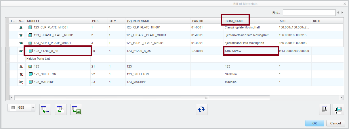

I will assemble the screw and check the EMX Bill of Materials

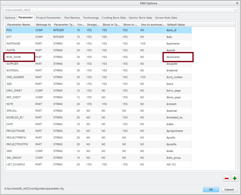

In the EMX standard configuration ( Open EMX Options > Parameter) a STRING parameter called BOM_NAME is defined. this Parameter has a default value assigned which is called &bomname.
This default value is now looking for the BOM Name definition in the Part Names and adds this value to the parameter.
