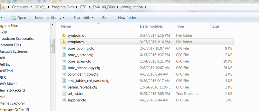

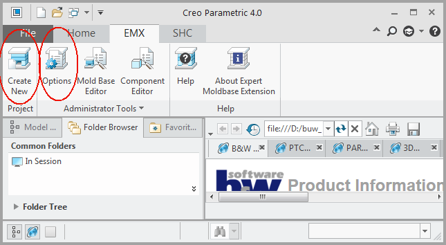

Some customers have reported problems when trying to use EMX the first time after they have installed it. Usually the functions
"Project> Create New" cause a crash OR "Administrator Tools > Options" show empty sheets.
In this case, please check the content of the folder <emx_install>/configuration. If you see only this files:

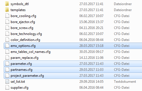

the most important files to run EMX are missing. They are shown here:
This are localized files that should be created by EMX when starting it the first time. Since MS Windows 8 the handling of Administrator rights for the folder "C:\Program Files" is rather restrictive, therefore EMX is not allowed to generate this important files!
To solve this problem, either make sure you have 100% administrator rights for this folder
OR
install EMX into a different directory.
