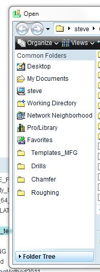

    you could add your folders to the common area. The only problem I find with doing that is you have to be carefull because it sets the last visited folder as your working folder it seems.common_folder.JPG
