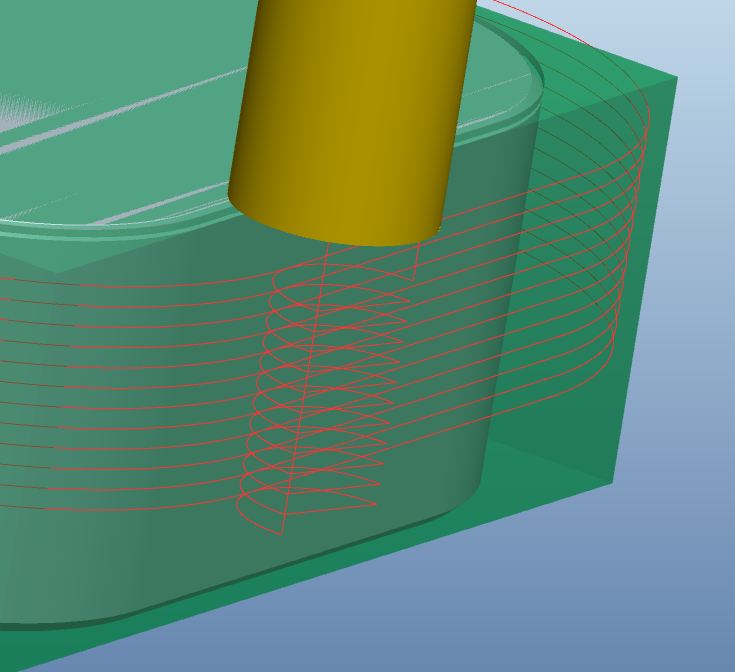

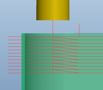

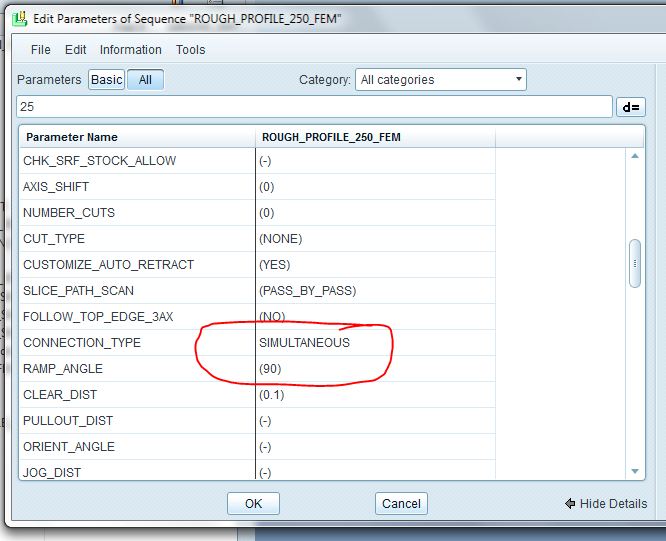

I don't know if anyone knew this parameter that i discovered this morning while trying to get the tool to stop retracting between passes. But it does stop the retracts while trajectory milling a profile.
This seems to allow you to use lead in and out and move to the next cut without a retract in trajectory milling!!
I didn't think it was possible.
Sep 1, 2011 2:11 PM UTC
here is a picture of the tool path motion. been looking for this for a long time.
