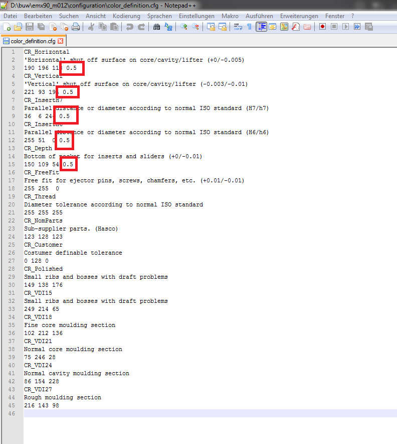

Simply edit the file color_definition.cfg in the configuration folder.
You can add a 4th coloum for each technology color between 0 and 1 to set up the transparency.

I just updated tha color definition file per your suggestion and it does not work.
I guess we need an update of the EMX then. Could you provide us with an update? M012...
