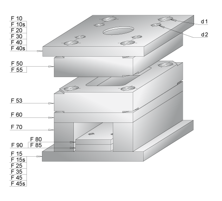

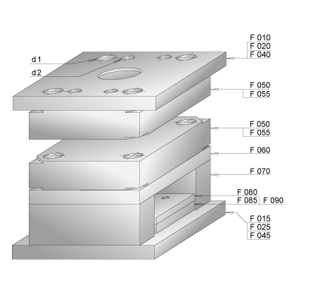

Usual moldbase (oblong):
Transversal moldbase:

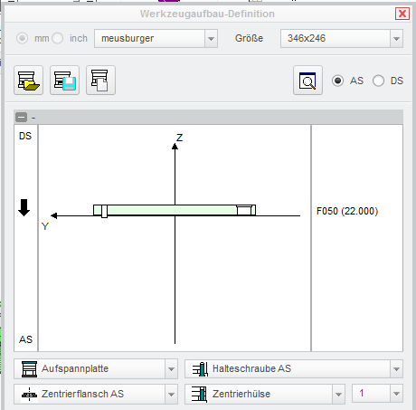

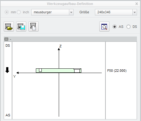

I see in the picture that you use the Meusburger Plates for your Molds.
EMX has the tranversal Moldbases of Meusburger already included. If you have a look at the 2 pictures below.
Regular size with 246x346 has order number F50
Transversal size 346x246 has the ordernumber F050
Regards
Thomas
