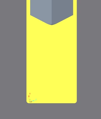

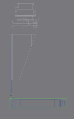

Is there a kind soul out there who would like to help me set up the turn-grooving tools?
Can't find out how to setup TIP, OFFSET CENTER and so on.

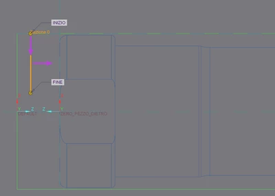

Yes , That's the explanation but to me it's still not clear how to set everything.
Let's show an example.

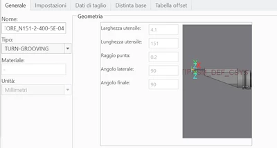

This is my settings:
The TIP csys is at the center. Nose radius is ( 0.2 mm)
Insert Width is 4.1
Nose Radius is 0.2
Let's say I need to cut this:

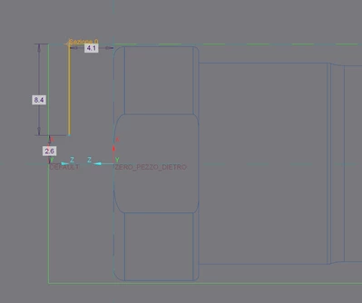

Should I make a profile at 4.1 mm distance from the part ?
Like this:

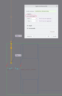

Material direction to remove:
offset cut checked like this:?

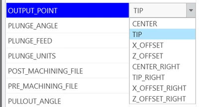

How to set the OUTPUT_POINT in the parameters dialog box?
