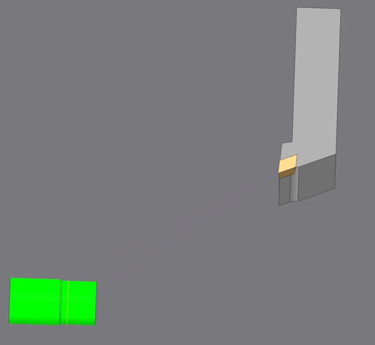

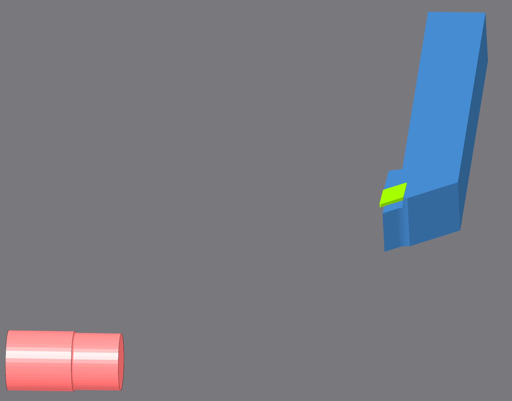

I am trying to show solid tools on ModuleWorks but I don't know why only the holder is shown and not the insert.
I attach two pictures
SOLID_TOOL.png is shaded in Creo
SOLID_TOOL_2.png is in ModuleWorks. The holder is ok but the insert not
Both Holder and insert have a CSYS called INSERT
Holder has the parameter : VERICUT_TYPE set to HOLDER
Insert has the parameter : VERICUT_TYPE set to INSERT
Any idea why?

A reason could be if you use sub-assembly in your tool design. Sub assemblies are not supported by Moduleworks.

I tried with a simple asm with two components, the tool and the insert.
You can find the asm in the reply to MaheshSh
What is strange is that always the insert is not shown.
Probably I am missing some parameters
